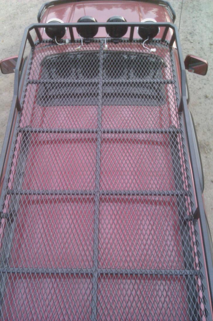

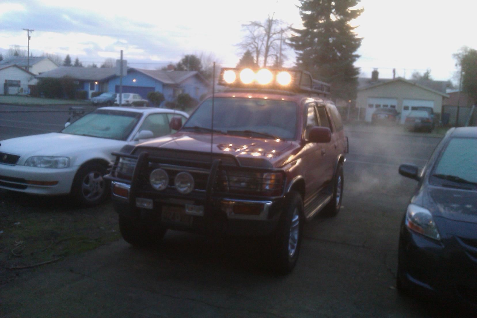

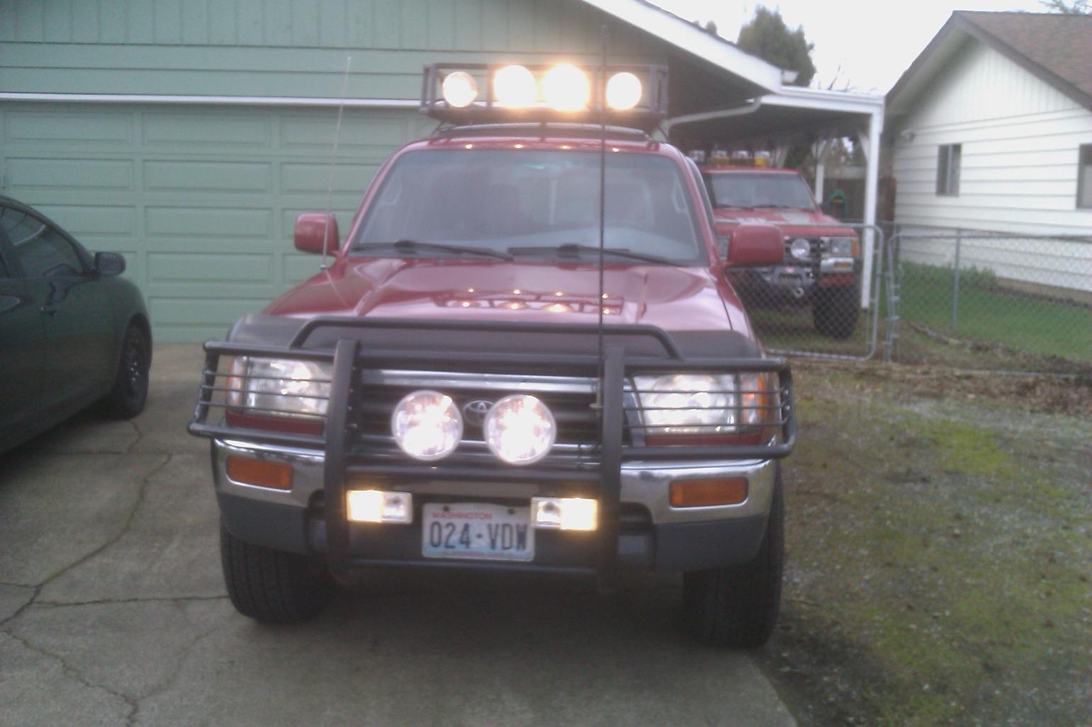

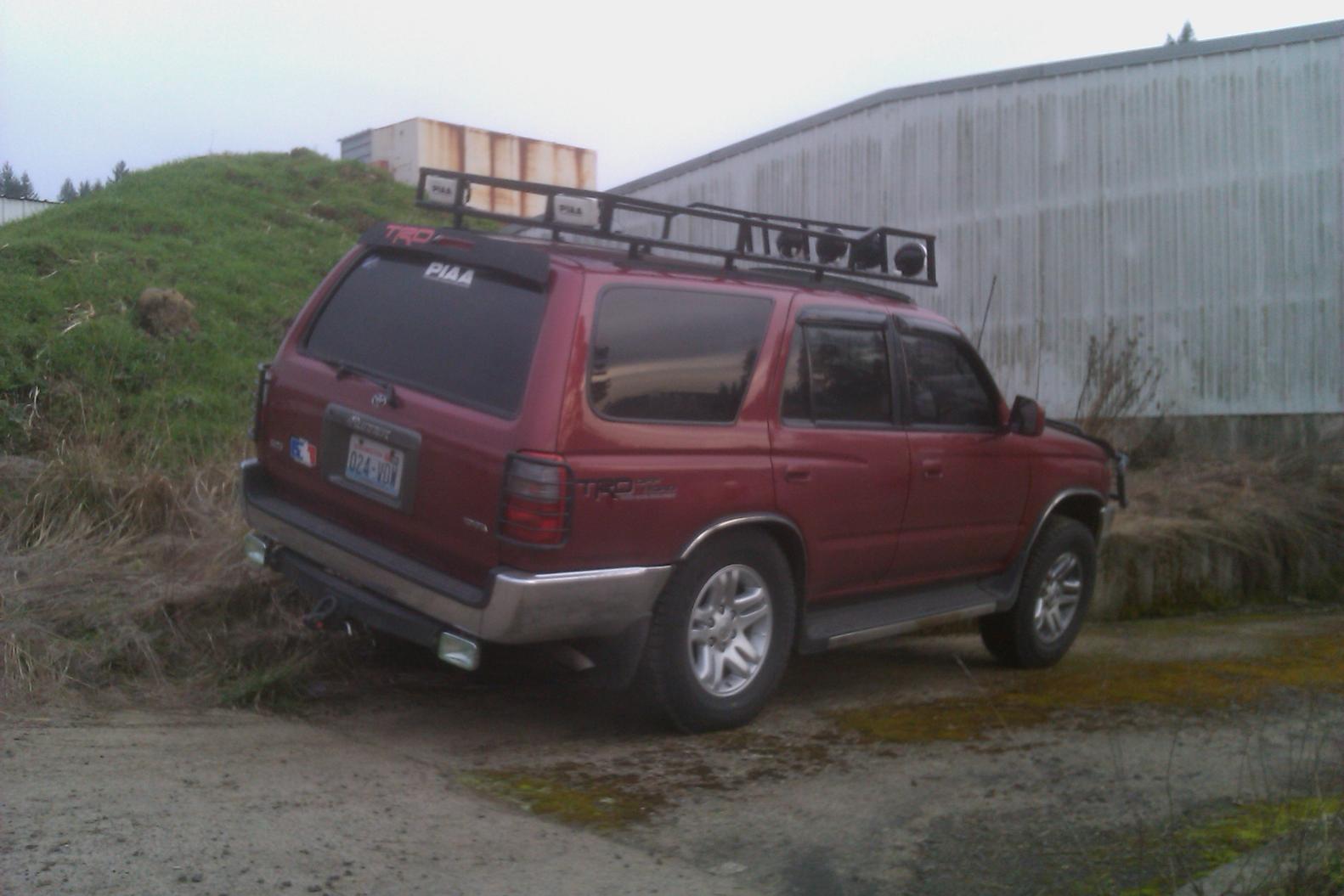

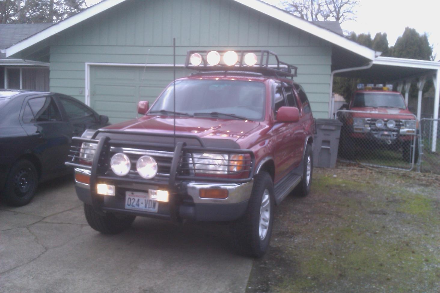

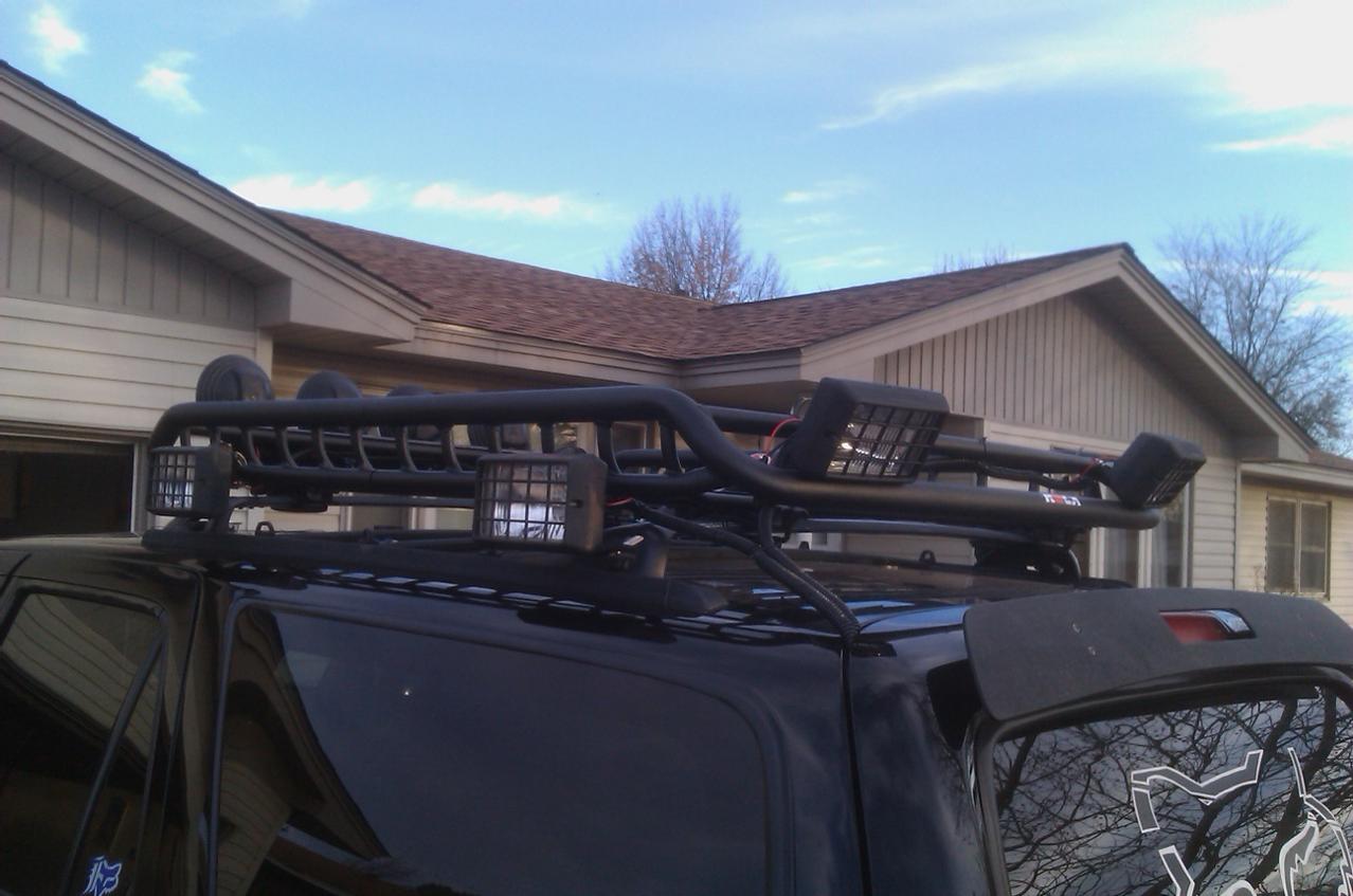

so i got it done for the most part, they are all wired in, as you can see from the pics(i will get pics of how i wired them for now, its only temp, i need them for this next weekend -road trip lol). i figured i would show you all some pics of this thing. ill be making more. this is only the demo/prototype unit. its kinda overbuilt so the next few are gonna go on some "diets". enjoy
