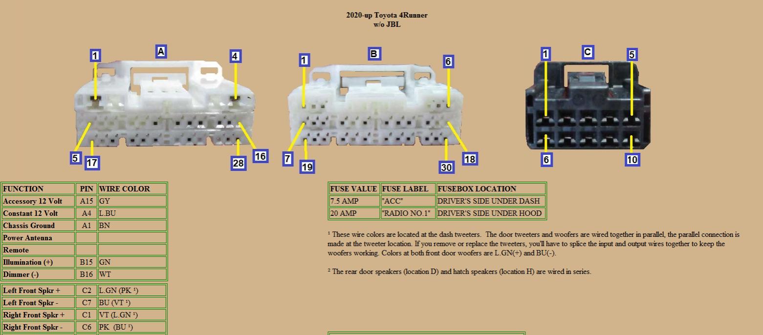

Wiring diagram!
Thanks for the post and these replies. I’m looking to install a subwoofer/amp using a line output converter. Ideally, I’d like to find a T harness specific to the factory head unit, but if not, will need the wiring diagram. Where are you getting this information and does it include actual diagrams?
I just bought the Toyota specific PAC harness for my 2016 4Runner with the non-JBL stereo. I bought the JL Audio line out converter and was gonna connect it to a JL sub and amp. Decided I’m going to just do a 5 channel JL amp since I upgraded all my door speakers too.
The PAC harness is awesome, will work perfect for mono or multichannel amps. It’s $59 on Crutchfield
Wondering the same! This is what I was given for my 21 T4R. Reeeeeally don't want to tap the factory wires.
I was wondering where did you get this diagram from? Couldn't find it on TIS? I need one for a system with JBL.
Thsnks!
Thsnks!
Try Crutchfield Audio. They specialize in audio upgrades and components for cars & trucks and know the pin outs for most radios.
