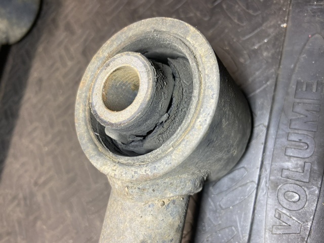

I can almost guarantee it’s your rear lower control arm bushings. I had the exact issue around the same speed when hitting a bump in the road and it would sway left to right like a pre-teen girl at a Justin Bieber concert.
Mine were beyond toast and the problem went away when I replaced the control arms with some upgraded aftermarket ones.
You might be able to see the condition of the rubber without unbolting them if you get underneath with a flash light, but visible cracks in the rubber or not, it’s those bushings I’m sure.
