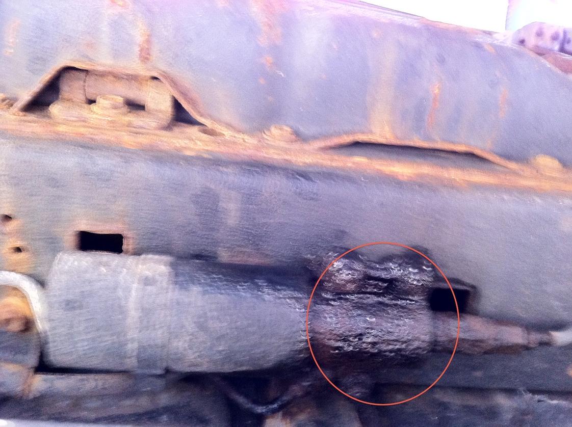

so today as I went about my drive to work, i walked up to the 4runner (03 limited v8) and noticed a two small puddles underneath it.
both located on drivers side, about midway down the suv.
i looked underneath, and the leak is very very slow and seems to be coming from just underneath, inside from the running board.
looks like it along a piping/line on one and another is around a cannister like object with a line going into it, and coming out pretty much midway along the running board (as reference).
Brake line?

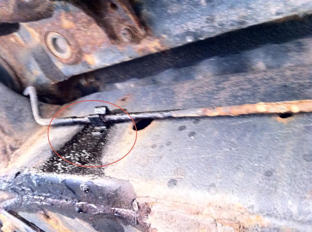

took some quick pics with phone cam...sorry about the quality.
This should give you lucky sob's down south who don't live in the rust belt an idea of what we have to deal with up here!!
first pic is of the 'capsule', the other one is further upstream, closer to driver's side front tire...

so, looks like i will likely need to replace my xreas setup? grrr

your 20034runner looks like my 1999 4runner that had coolant lines rotted thru like urs. My 2004 4runner still looks clean and i live in new england.
xreas replacement is a pita and not worth it. at this point i think u should strip out the xreas and replace with regular shocks.

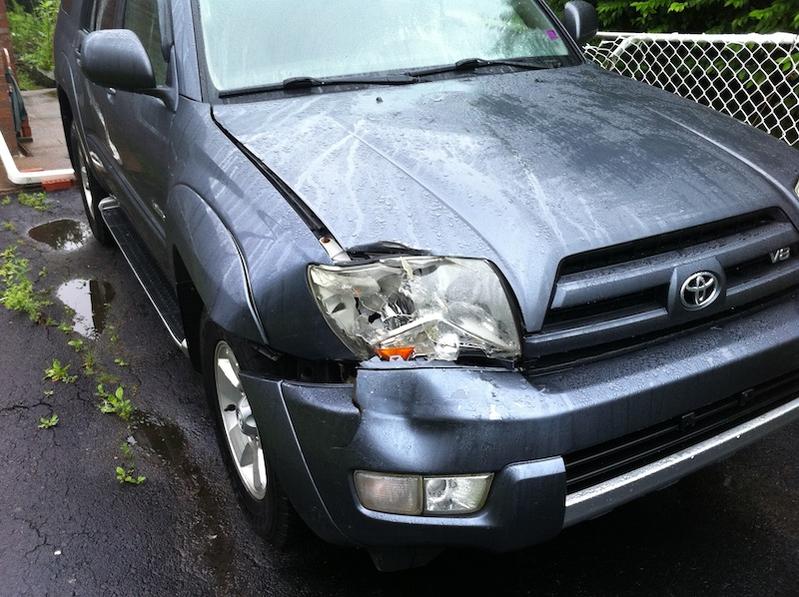

bad news...got in a fender bender, didn't realize people made complete stops at yield signs with no oncoming traffic! oh well, my fault technically...here's the damage
