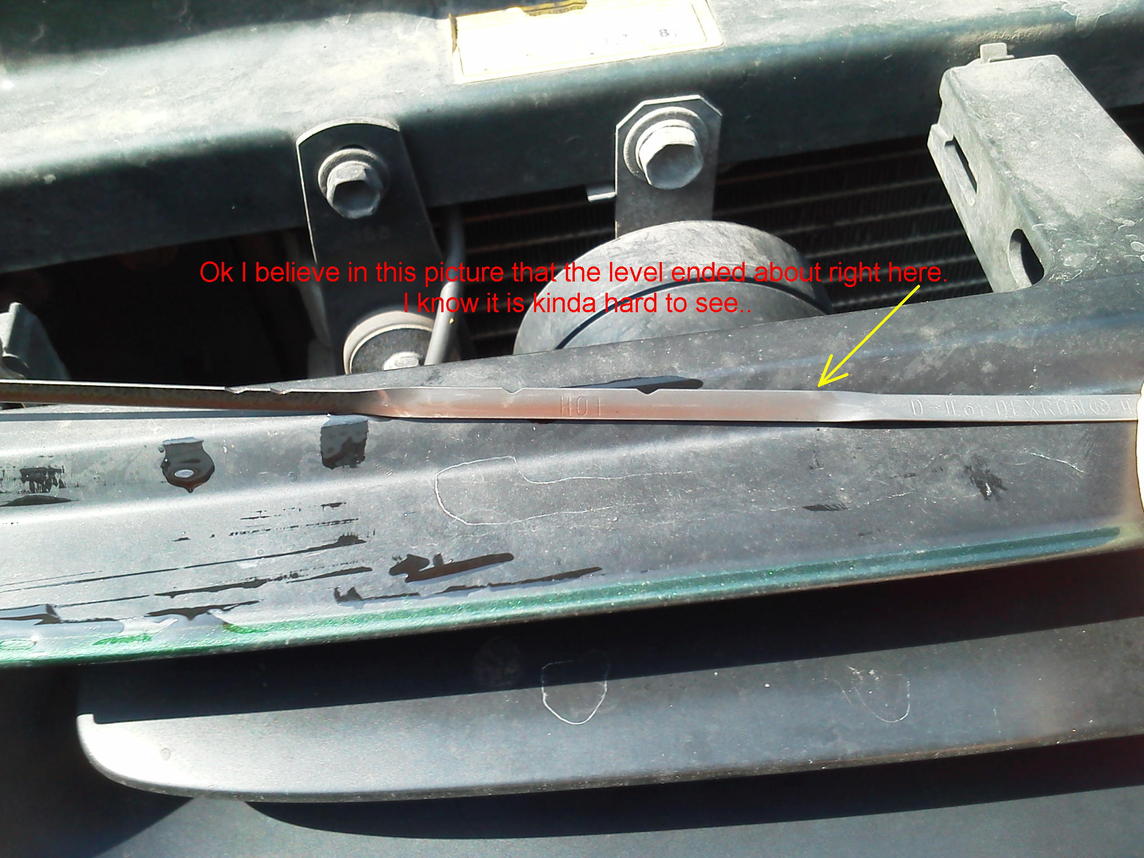

Ok so as I backed her out of the garage everything appeared to be normal backing up and didnt have to give it much gas like usual and I backed all the way out to the end of the driveway. Then I put it in drive! (first without giving it gas at all to see what it would do) well it drifted forward approx. a foot and then stopped like I hit the brake! So I decided to tap on the gas a lil. I didnt have to push on the gas that much to get it to move it wasnt really that bad and then once it started moving while it was moving I shifted it to N (Still in driveway) and it drifted for approx. about 3 feet and stopped as it should like normal while in N! Ok so I played around for a bit in the drive way doing that back n fourth for a bit. It wasnt too bad today maybe because its warmer out today and in the 70's. Maybe it is a cold issue I dunno!
OK well anyway I decided to go and try and recreate that situation when I slid and it first started doing that on that same hill. Well I had no luck getting it to do that again on that same hill. It was running great actually and wasnt doing it at all!!! So I figured I would pull back in my driveway and try it again and it didnt do it at all pretty much. The truck is way too warmed up now!
So then I drove it about 5mi. down the rd. and went and did some shopping for my lunch for work tom. and I played around in that parking lot for a bit trying it out and seemed to be working fine and just had to give it a little bit of gas for it to move going forward (it would start to move like normal and then I would gas it just to get it to go a lil faster but didnt seem to be doing what it was in my driveway when I first started her).
Ok so I drove it back home and I figured I would check the tranny fluid after all that in my driveway.

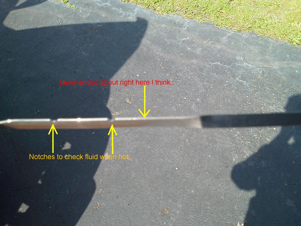

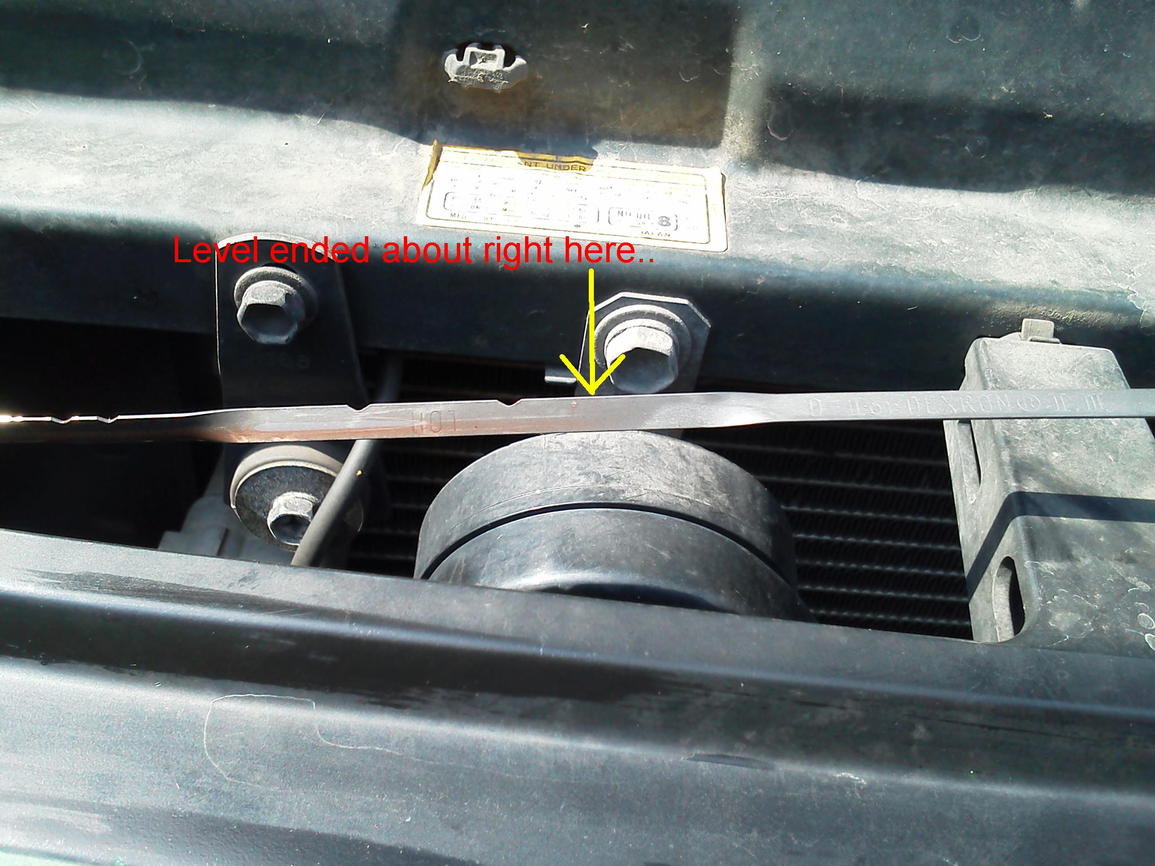

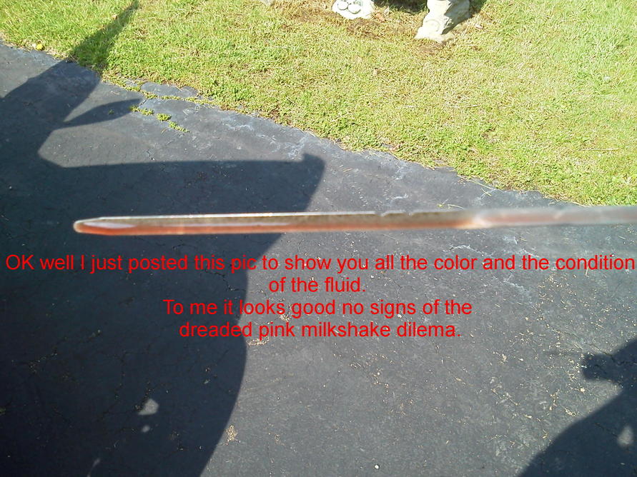

Ok now I know you guys are gonna think im weird for doing this but I was bored and I did it anyway lol I actually took a few pics of what the level looked like on the dipstick for you all to see. Well to me it looks like it is too full (about maybe a 1/2 an inch past the hight level mark) and which I have known this since I had bought the vehicle but didnt really know how to drain it and well it was supposedly serviced right b4 I had bought it and I figured well if it were too full they probably would of drained it. But now that I think about it I know I was wrong to think that way and well I kinda left it like that for 3 years now! Do you think having too much tranny fluid would cause this issue?? Kinda weird it would just all of a sudden start doing it now after 3 years?? How hard is it to drain a little bit of fluid out??
Ok guys well here are some pictures of the dipstick level and figured well I might as well take a few other pics of the truck for you guys to see. Shes nothing out of the ordinary but I like her!! shes pretty dirty though ugh! Now to get em on here hmmm!
PLease read what I wrote on the pics! It tells you where I saw the level at when I took the pics. I know its very hard to tell in some of em where its at..

When you check the level, you're supposed to slowly row through all the gears in the tranny, then on level ground, put the truck in P or N, pull the dipstick, wipe it clean with some shop towel or a rag, and then put it back in the tube, and pull it out and check the reading. If you've done all of this and that's where the fluid level is, it's way too full.
I would drain the fluid from the tranny pan, and fill it back to the proper level, and see how things work after that.

PS that tranny fliud color looks great, however, it may be a little full. I don't have mine over the top notch in HOT. As others have said. This tranny is sensitive to fluid level.
