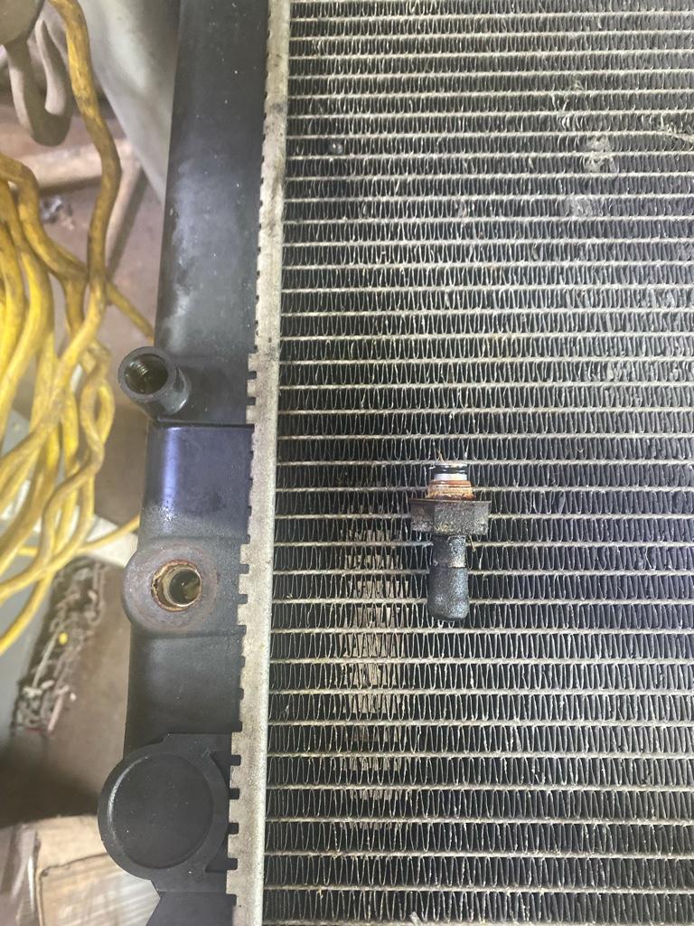

After this weekends fiasco leaving me on side of the road with temp gauge in the red I started thinking about last week. It’s been getting cooler at night and in the morning a few days I noticed high idle for longer than usual. I assumed was taking longer to warm up but was weird. After the 2nd day I looked for vacuum leaks and searched around for possible causes thinking it could be a couple different things. Turns out antifreeze was leaking and or water pump not working. Not sure if water pump failed but I got lucky. Changed pump, radiator, cap, pulley, belts etc and back in action. Moral of the story check your fluids anytime you sense something haywire.
