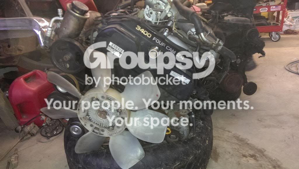

First day when I got the motor.
After I cleaned it
Motor wasn't dirty to begin with. No oil sludge nothing. Timing belt was done at 96km around 56 miles. But I'm putting new one, new front and rear seal new thermostat. JDM motor around 30-60 miles
