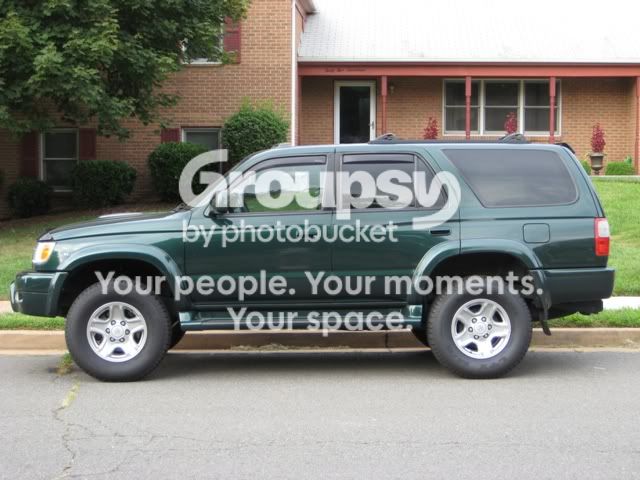

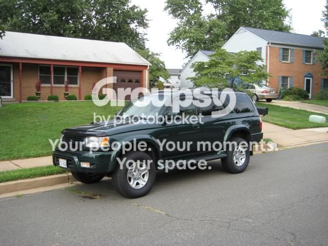

I'm running 99 tall coils in the front and 906s in the rear... The rear is about 1/2 inch higher than the front in my 2000 SR5.

The street slants towards the house, so you see a little more wheel gap in these pictures compared to level ground. No complaints about the set up... I tried the '99 coils in the rear but wound up with a reverse rake. The 99 OEM coils were also pretty weak... couldn't really carry much in the rear without major sag.

I run 906s and Billy 4600s with my original factory '99 talls and I sit about the same as [MENTION=27221]Batsoff[/MENTION]. Theoretically the 4600 Billys get no warranty with the 906s but I'm not too worried about that. I like the setup.
