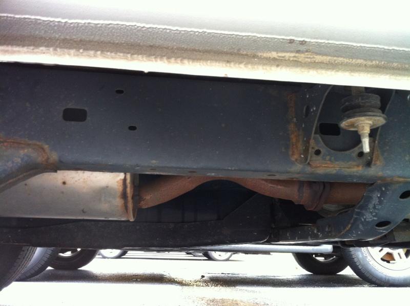

Wreck was in 2009. There's a tiny bit of rust on some of the welds underneath but its pretty rust free besides that. The truck lived in Maryland and NC before it ended up here in south carolina.pics to follow

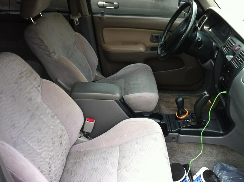

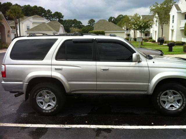

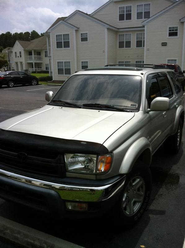

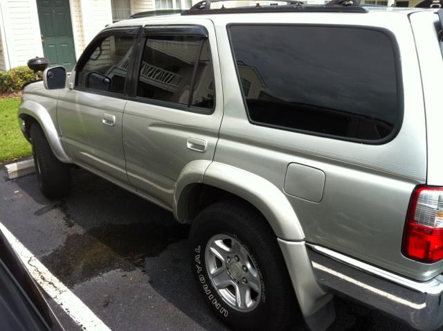

Seems ok
5k seems ok. Looks clean. Take it to a mechanic for a check up. Whenever I buy a used car I take it to a shop for a full check up. It is money well invested and mechanic will be able to tell you if frame is out of whack or any engine issues.
My .02 cents
Ruff
Why is there a TAN leather door panel when the interior is GRAY cloth? Also, look at the messed up panel gaps underneath the headlight and corner lights. The front bumper is also missing the fender flare extension. Have it checked out really well.
Oh crap.. I didn't even notice that.. damn I thought I'd found a good one

My undercarriage rust looks very similar to the pics posted in this thread. Mainly on the welds, with a few spots of concern and some paint flake and rust on the rear axle. Think I should do anything to treat it or would I be fine just leaving it the way it is? It was originally in Illinois and Wisconsin, but is now in Alabama.
Yeah. Tell the buyer about the problems I noticed and mention the timing belt as well as why the undercarriage is so rusty for an SC truck. Either this guy is clueless or he is trying to scam you because that is not worth $6500, let alone the $5000 he went down to. Maybe $3500 is fair in my opinion, otherwise just walk.
