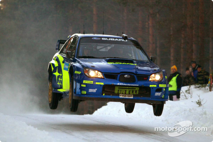

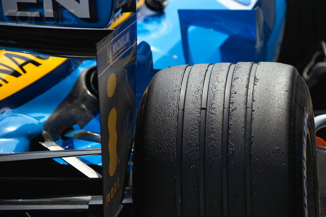

Hope your not talking about snow traction??
You never want a wide tire for snow traction, you always want a skinny tire. Skinny tire means more PSI down on to the ground.
Just look a Formula 1 tire versus a WRC snow tire. (Pics)

Never say never. If you want your tires to bite down to the pavement below, then you want a skinny tire. If you want your tires to float on top of the snow (because it's too deep to reach any traction below), then you want a wide tire.

I'm sorry there are instances that I over looked. I was aiming at street traction.
Those Arctic trucks are in a league of their own!
