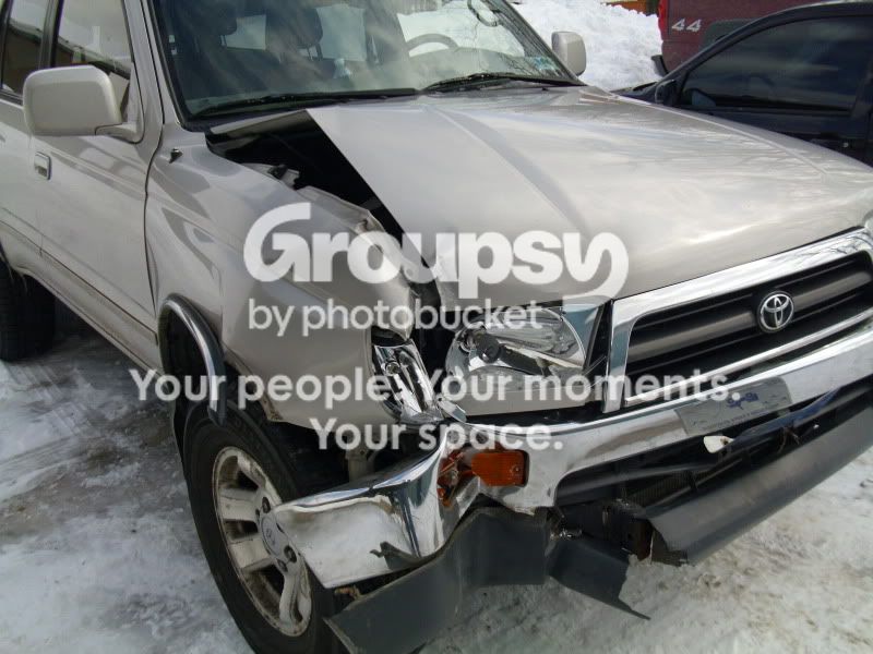

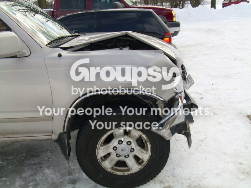

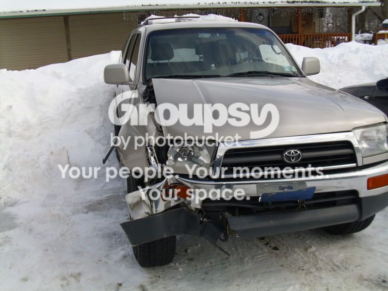

Didn't have a good night Monday the 17th. I was driving thru town and a car did a u-turn in front of a couple of cars up in front of me. I was watching him thinking what stupid move was next as it looked like he was going to pull out again and the cars in front of me stopped. Well I didn't as I was still watching the dumba** guy.
The Jeeps bumper and hitch went just over my frame so that is untouched, But the rest is pushed almost into the motor. Mostly to the right side. Left fender is untouched.

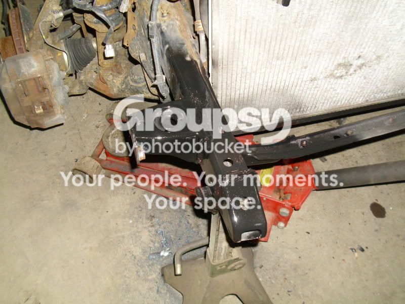

This one shows how far everything got pushed past the frame.

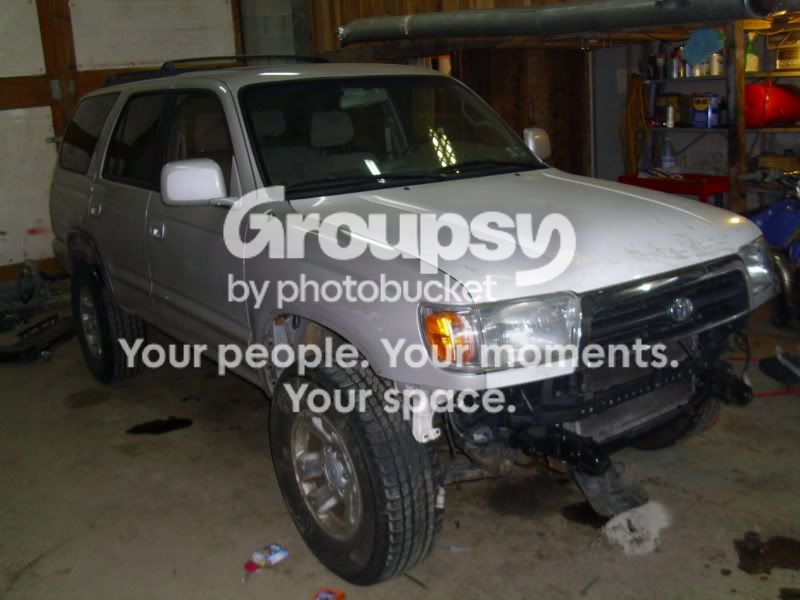

This was before the sport hood and lining the fenders and hood up to get the lines right.

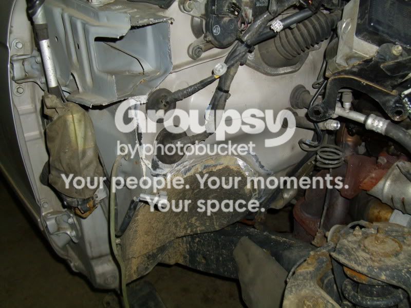

Ok I got a little time to hit the garage tonight. Got the right fender off and cleaned off some undercoating in the wheelwell. There ARE spotwelds to remove the inner fender. Pics are in the link below.
I also took more pics of the damage to the right wheelwell.
96 4runner wrecked 1-17-11 pictures by muddy_4runner - Photobucket
Now I just need to find someone who has replacement inner wells
I really wish I had taken my time to look for spotwelds it could have looked so much better.
