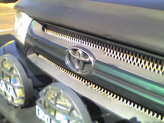

Hey thats kind of what i did to mine a few weeks back... but mine is wayyyyy sicker ha ha. Sorry she was a lil dirty in this pic, the yota badge actually matches the color of my truck
this pic does NOT do this justice, Ive seen this in person, very nice job, and the YOTA is just icing on the cake, lol
