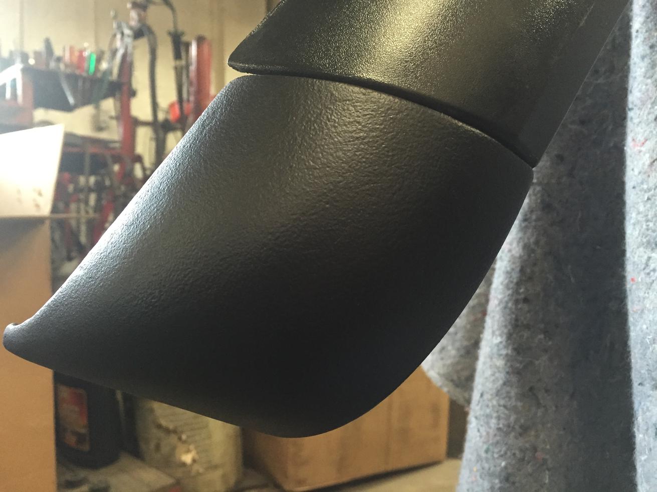

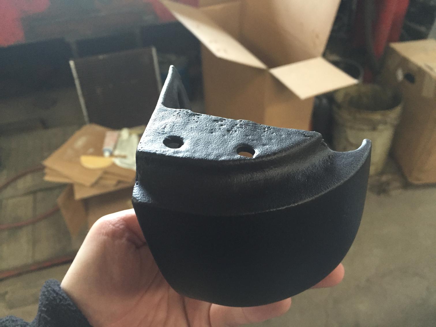

THE GOOD: these caps are a solution to the problem that SR5 owners face when removing their running boards. The caps are shaped well, and line up nicely with the curves of the stock plastic fender flares. I ended up painting them with SEM texture coating spray, then topping that with SEM bumper paint. The texture doesn't match the stock flares perfectly, but it's pretty close. Unless you're examining them up close, you'll never notice.

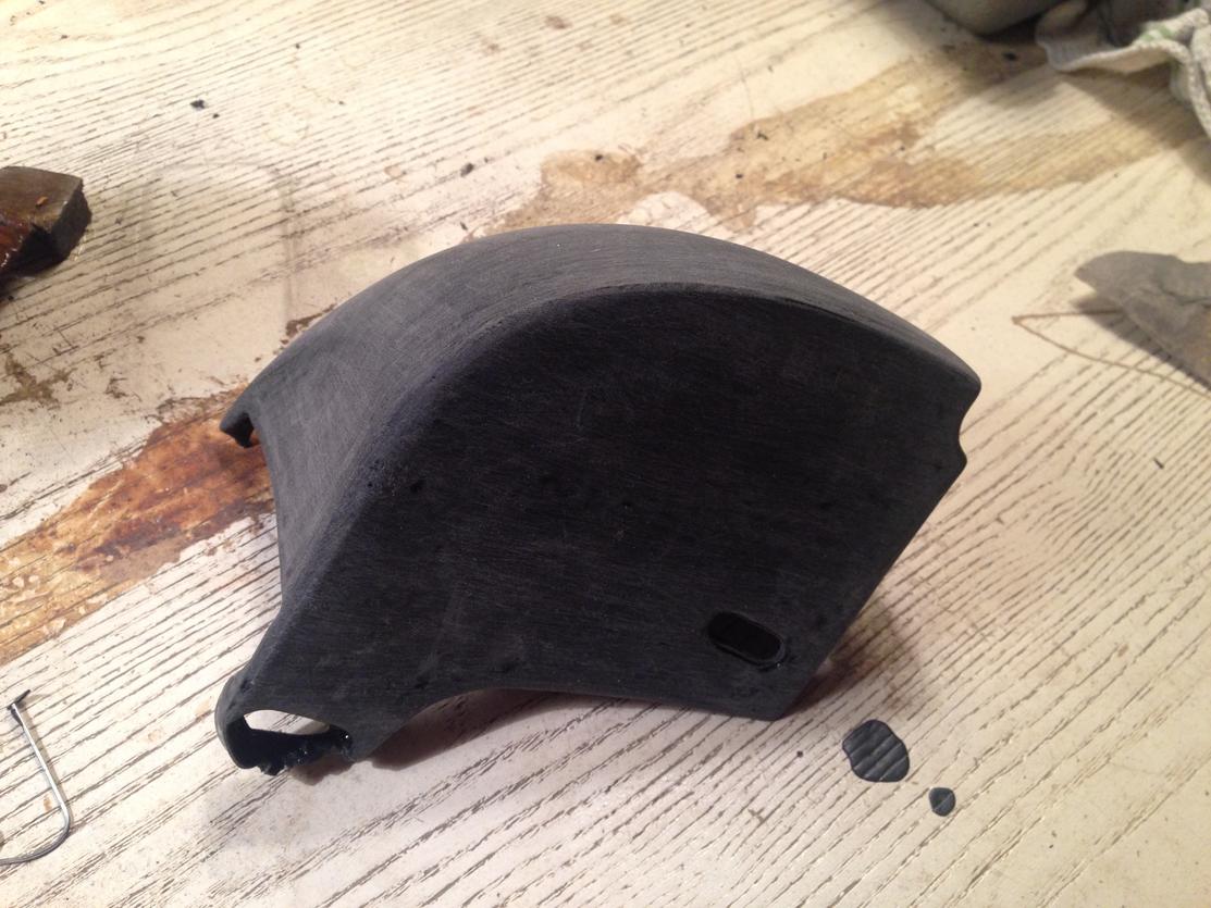

THE BAD: the acetone washed caps are being sold as "ready for paint" but I don't agree with that. While I would definitely recommend spending the extra money to have them acetone washed (because it adds significant strength to the caps), I wouldn't expect to receive a part that only needs paint. My caps had a lot of unevenness in the finish that required a lot of sanding, and this uncovered some small pitting as well, which needed to be filled with bondo and sanded back down.

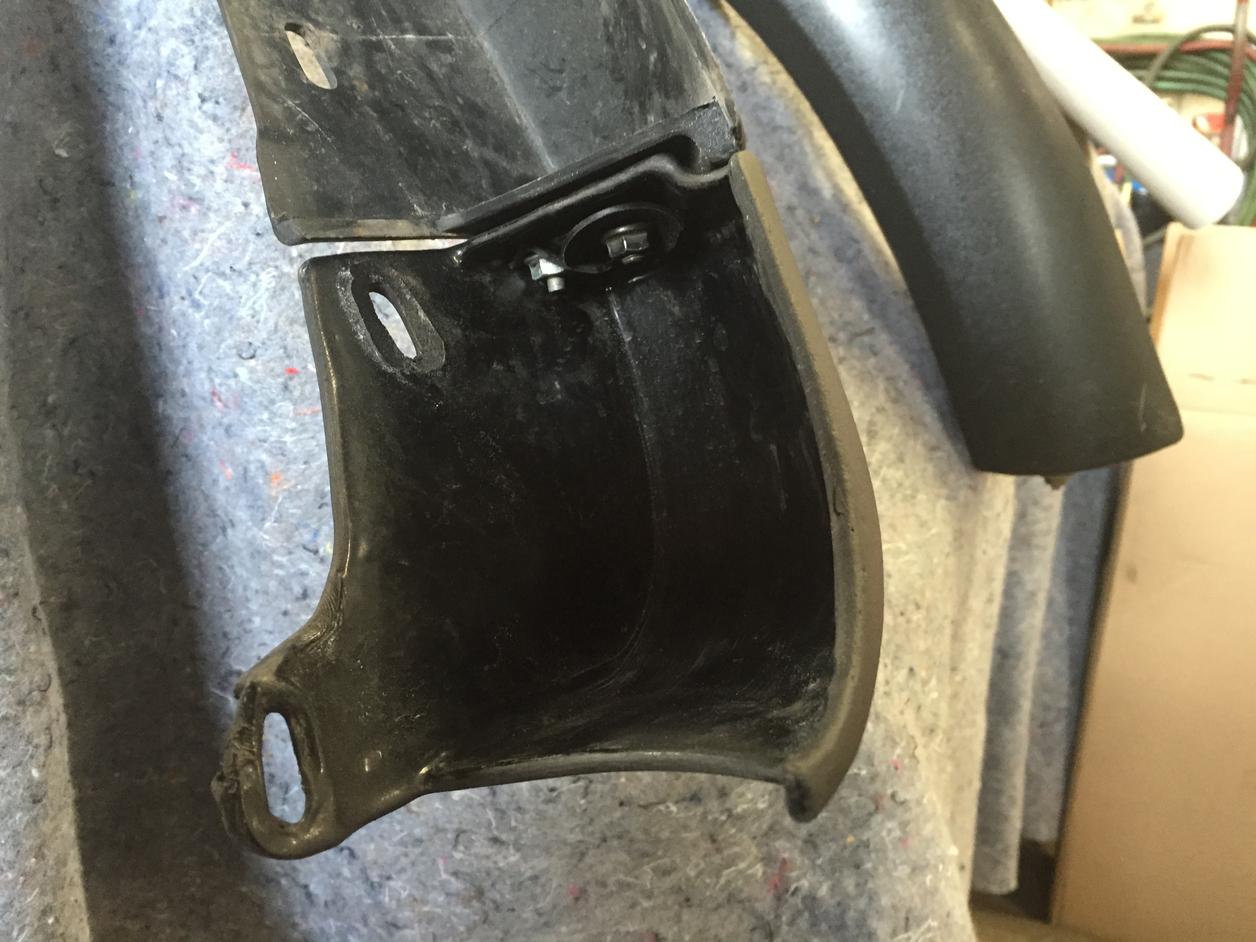

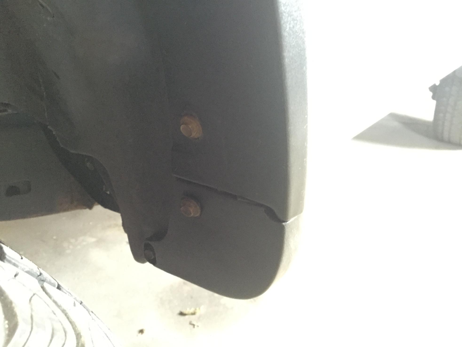

MISC: I tried using zip ties to connect the flare cap with the flare, but I wanted a more secure fit between the two. Instead, I used nuts and bolts, with rubber washers between the two parts and under the heads of the bolts. I was able to tighten them securely and didn't have any problem with the parts cracking.
I am somewhat concerned with long-term durability, as the plastic does seem more brittle than other plastics used on the outside of vehicles. And over time they may become more brittle, due to the aging characteristics of plastic. But I did accidentally drop them a couple times, and they were fine, so time will tell.

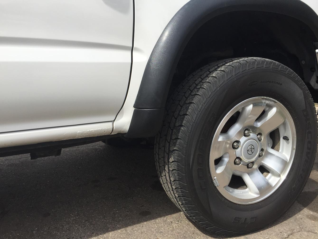

Onto the pics:
After some sanding:
Painted:

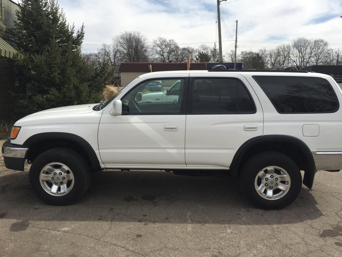

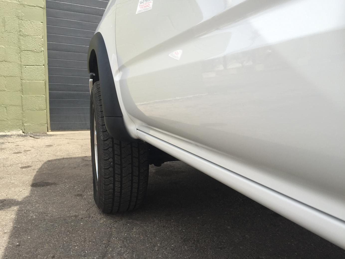

On the truck:

they look pretty good. I was always a fan of white 4Runners with black flares. the only thing keeping me away from putting them on my own truck is how much they cost. I have spent a lot on little things in the past but I couldn't get past the price this time around.

Thanks, I'm happy with how they turned out. The cost was hard to swallow, but I wasn't going to take my running boards off until I had a solution to the gap. And I really wanted to take the running boards off....

They look great! It's the small things that I notice, and I have always been bothered by the gap left. It looks so much better with these or the mudflaps.
