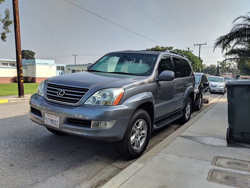

honestly, i was going to buy my brothers 2004 t4r se v8, but SURPRISE SURPRISE he wants to keep it (at least for the time being...). he is the original owner, and i was waiting for a while for him to sell, and it just wasn't happening. anyhow, just to be different, i decided to go with a GX. still love his t4r, but i really like my GX... luckily i found one with a nice clean undercarriage (i.e., no rust) but it must have sat in the sun forever. all the rubber was dead, so i replaced the door belt mouldings, front inner door panels, wipers, and like i said the dash is cracked. had to also replace the radiator, but the PO replaced the timing belt and water pump just before selling (common maint). otherwise, just been collecting fun parts (like suspension refresh/upgrade, tires, etc.).
