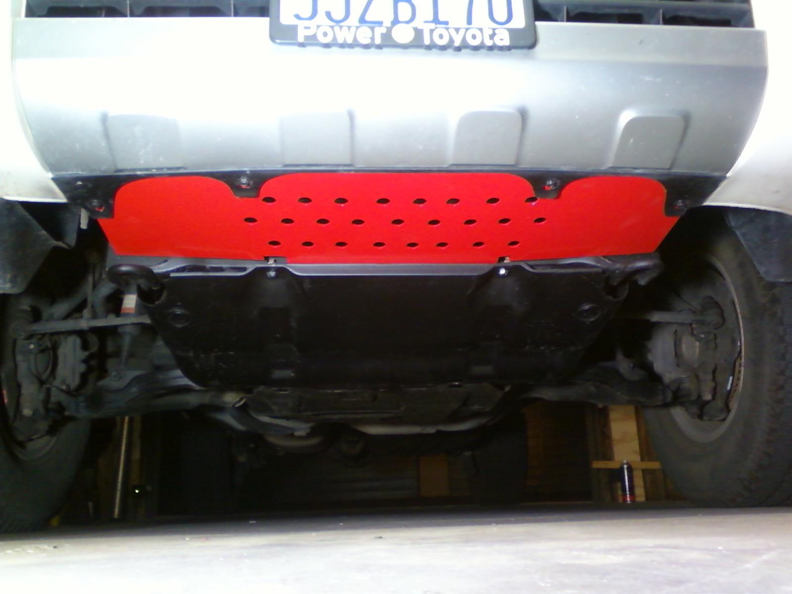

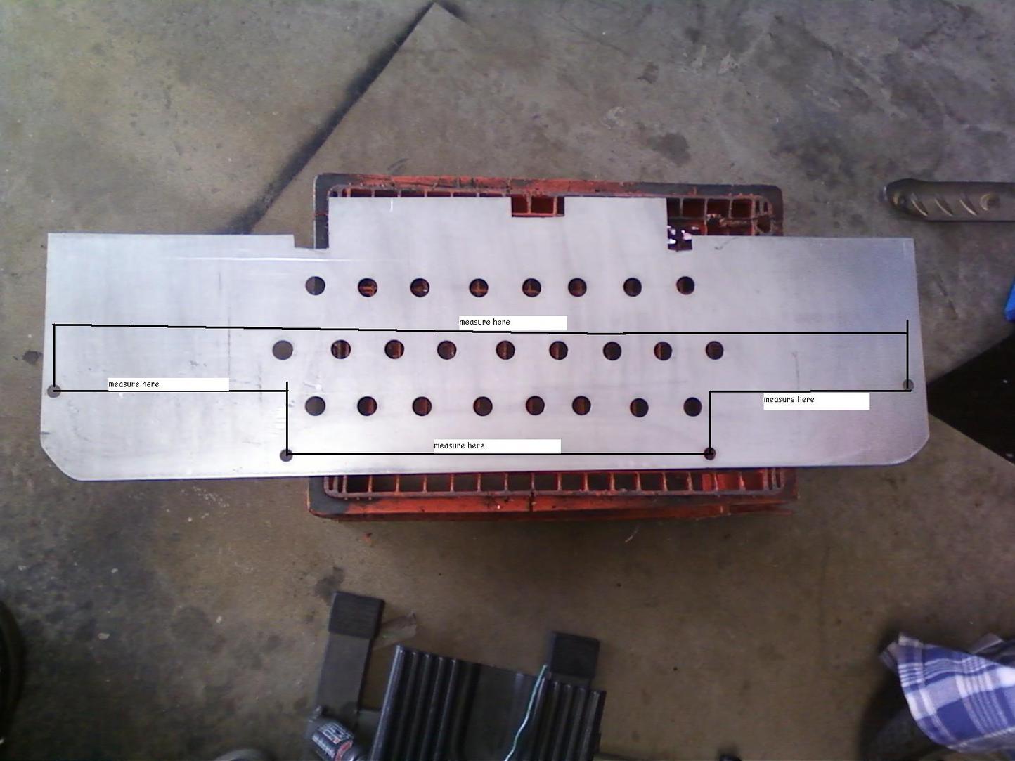

just make your own like i did. its not hard.

That looks good. Is front mount to the bumper strong enough to support it in let's say water crossing where it'll get plenty of pressure against that area? It looks as it is attached with plastic tabs on plastic bumper.

There are actually steel tabs on the upper side that are oem for holding the bottom of the front bumper that this bolts up to using stock bolts. The ones I normally make fit an 03-05 due to the fact that in 06 they changed the way things are bolted and held in place. I think I might have a few in the garage that are already primed up and ready for paint.
