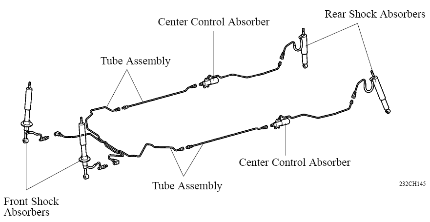

X-REAS features variable oil pressure in the shocks, with opposite corners connected to each other (like an X) by oil lines to decrease the amount of body roll in turns. Therefore, they're special shocks to replace because of that variable control.

I know NOTHING !!! but would not think they would be bad at this point. Ask how they came to that determination.
I have 58k on mine and no problems with the XREAS and no weird tire wear problems. If one or more shocks shit the bed then your handling would suffer. Ever drive a vehicle with bad shocks? It tends to bounce a lot more and for longer times than usual. Look around the shocks and see if you see any wet spots. Also check those hard lines connecting the shocks to one another.
Anything is possible. Maybe they should check the ball joints and various bushing on the front suspension.
I do not think it should have worn out by now, although it eventually does have issues with some people.
If you have to replace it, I would go with a better setup than the stock suspension parts. OME for example is a better ride, as well as cheaper than 1k. I never even noticed a difference when I had my Xreas disconnected, so don't worry too much about not having it, if that is the route you choose to take.
