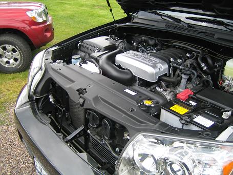

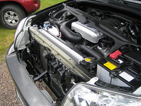

1st pic is of front before work is done

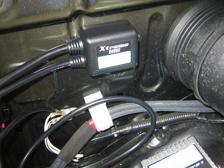

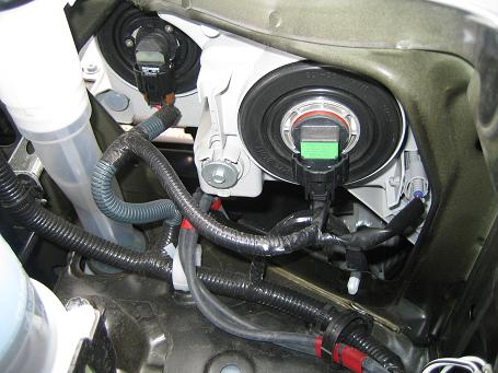

Wiring Prep
Then, pop up connnectors to remove plastic shield over radiator. This allows clean wire installation to pass side.

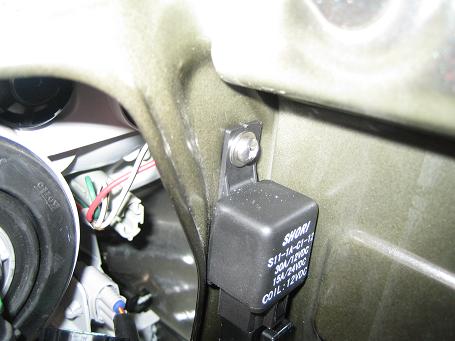

Relay Mounting
There waqs an existing hole in front panel which allowed for a through bolt (stainless of course). I did similar on drivers side.

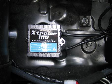

Other mounting
I mounted the other 2 components (I know one is a ballast, not sure about other one) . One fit nicely on the side wall, the other on inner fender. I did use the double sided tape to prevent rattling, but used 1 self tapping screw for security.

I was able to pick up a factory ground right on each side and was able to cross over power wire from pass side by routing under radiator support right along factory loom. All wiring is secure and out of sight under pastic shield once replaced.
