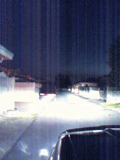

The conversion to HID is awesome!! i've got them and i'll never go back to anythign else. Teh thing you need to be careful of is that if you have aftermarket projectors, you have to make sure that they can handle the extra heat of the HID bulb. If not, HID's will end up melting the projectors.

My runner actually came with Projectors from factory.
So I guess it is pretty simple from there, no?
Yeah, it is really simple. What i do recommend is that you go about 6000k any higher and it will do more bad than good. At 8000K you'll start to get lots of glare off of reflections. at 10,000K the reflections and glare gets so bad that you your vision will be beter with regular halogens. If you are wanting fog lights, then go waht ever brightness.
