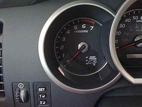

The X-REAS does NOT automatically come with the rear air suspension option. However, if you did have the rear air suspension option you would have the X-REAS suspension automatically included. By what you have shown, you have only the X-REAS and no Rear Air Suspension.
You can do a self-inspection to see if you have the air suspension by just looking and seeing the bladders. You would also have a HI-N-LO marker showing an outline of a 4Runner with a light in your tachometer. See photo.

So, I guess the question now is, "is air leveling suspension standard or optional on the limited models?" Because I have the limited model, but no air leveling suspension.
No, it is not standard on the Limited. I have a 2008 Limited and had to add the X-REAS and the Rear Air Suspension when I ordered it. You can always get a rear air suspension added however, so all is not lost. It would just have to be an aftermarket. I'm not sure if Toyota installs them after purchase, maybe someone else will chime in with a definitive answer.
X-REAS is optional on the Limited trim. Rear air suspension with X-REAS is optional and exclusive to V8 Limiteds. Limiteds can have the standard regular suspensions just like SR5, X-REAS like Sport Edition (V6 or V8), or rear air suspension with X-REAS (V8 only).
Rear air suspension with X-REAS is $950 MSRP. X-REAS only is $450. Spoiler is $200. Moonroof is $900.

Thanks Uneek, that makes scense now...so im not loosing my mind on this matter...lol. Anyhow, not that i needed rear air control, but the two empty slots in the console now give me room for a few "surprises". Thanks again everyone!
