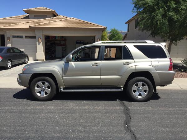

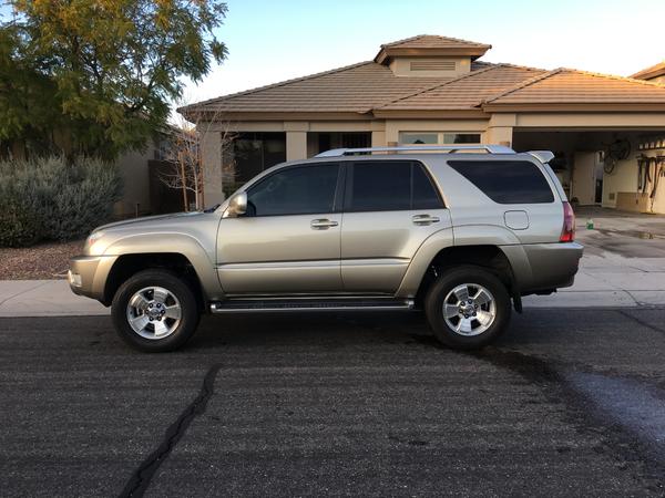

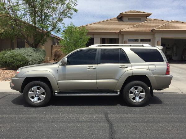

So you have a visual. Here is my 2004, 2WD, V8. My XREAS started to leak at 130,000 miles.
Pic 1 - Stock, XREAS shocks with OEM Springs.
Pic 2 - Bilstein 5100s, fronts set at .085 (second from the bottom) and OEM springs. Liked the look but I felt it was too soft. Also, it's like crack, you just want a little more.
Pic 3 - Bilstein 5100s, fronts set at .085 (second from the bottom) and MOOG, FJ 4x4 Springs. So glad I did it and I love the ride.
Now I need new tires and Wheels.
Nice.. Thank you very much for the pics, that's pretty much where I want to be.
So i'm guessing at 120k miles the stock springs should still be good. I know the MOOG rear springs had some issue, but the MOOG fronts do well.

I'm really pleased with the Moog springs. I had an issue with the OEM springs. At hard stops I would get the "clunk" more often. The issue seems to have gone away.
Regarding the rear springs I didn't have an issue with the install. Once they were aligned and I lowered the rear they dropped into place. What did freak me out was the left side. When I jacked up the back end i thought for sure I was going to snap the rear brake lines.
