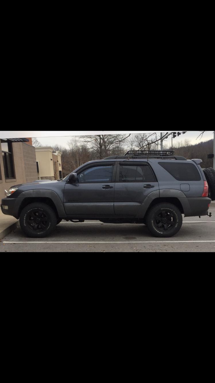

Hopefully this pic works
Crap! You've put some work into her! I love the rack ;)
How does it sound with the Flowmaster exhaust? That's the next thing on the list to swap out as mine is a bit tired.
Man, I love it to death. It’s throaty when you want it to be and of course won’t be quiet during regular driving but it’s not obnoxious. Lemme see if I can get my sound clip pulled up for you. I’ve still got a lot to do but my next plans are black out the headlight housings, tint front windows, and get wheel spacers
