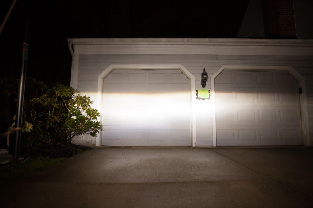

Original XenonDepot H11 LED kit to Xtreme LED Pro kit conversion
I had purchased the early version of the XenonDepot H11 LED HL kit back in 2016.
After seeing the latest version of the Xtreme Pro kit I decided I would give it a try and see if it was worth it.
[MENTION=12905]XenonDepot[/MENTION] graciously offered a price break since I was replacing the older kit with the newer one so I ordered them and put them in.
There is certainly a bigger "hot spot" since these new ones are clock-able.
I set both the new ones to 3 and 9 o-clock. Basically one side of the stalk with the LED chips is completely facing forward.
I took pictures facing my garage doors with the front bumper about 24' away. My driveway slopes down as you back away from the garage so don't focus on the height of the light on the doors other than to see that the upper cut-off is at the same place for all lights.
DSLR camera set to:
400 ISO
2.8 aperature
1/13 exposure
lens at 24mm
Shot RAW converted to jpg.
The first picture is the original XenonDepot H11 LED set purchased in June of 2016. Picture is untouched in the sense that I did not perform any corrections from the above settings other than to convert to jpg of-course.

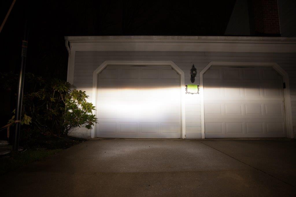

Second picture is the new XenonDepot Xtreme Pro LED on the Driver side and the original LED on the passenger side. Again, no adjustments from the above settings.

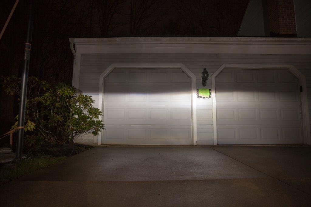

Third picture is the new XenonDepot Xtreme Pro LED on both lowbeams. No adjustments from above settings.

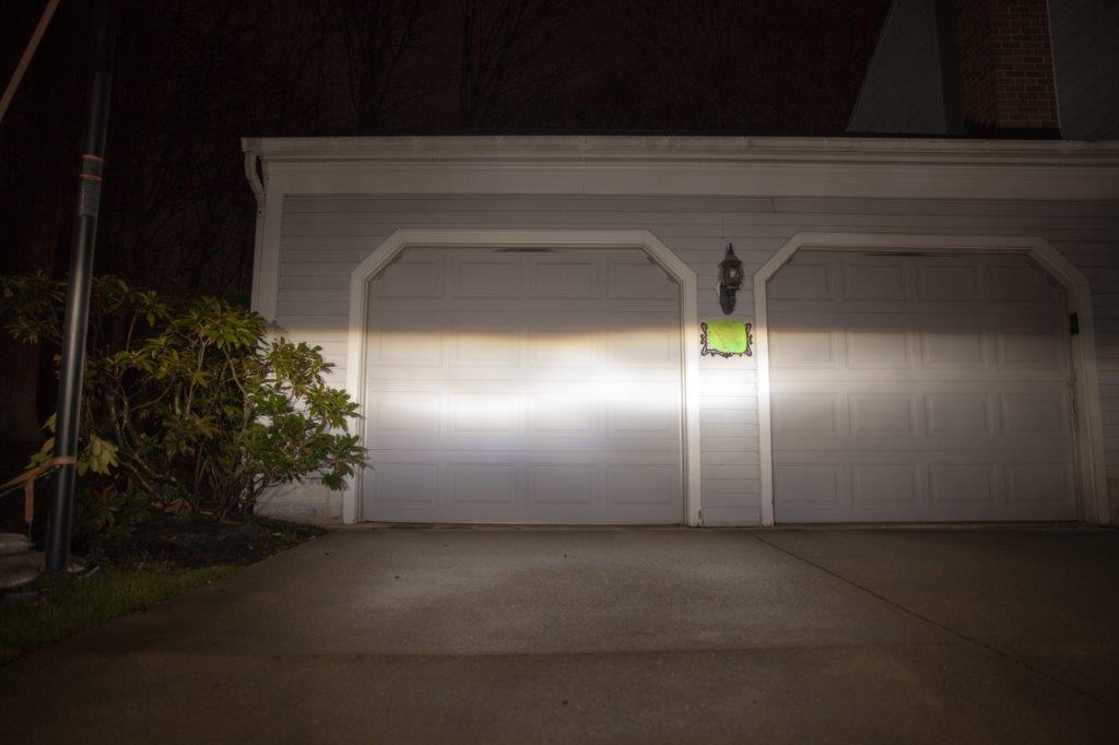

Fourth picture is the same as the original H11 LED set but now the exposure was auto corrected in LightRoom. there really isn't a "hot-spot" but a slim bright-spot near the top cut-off.

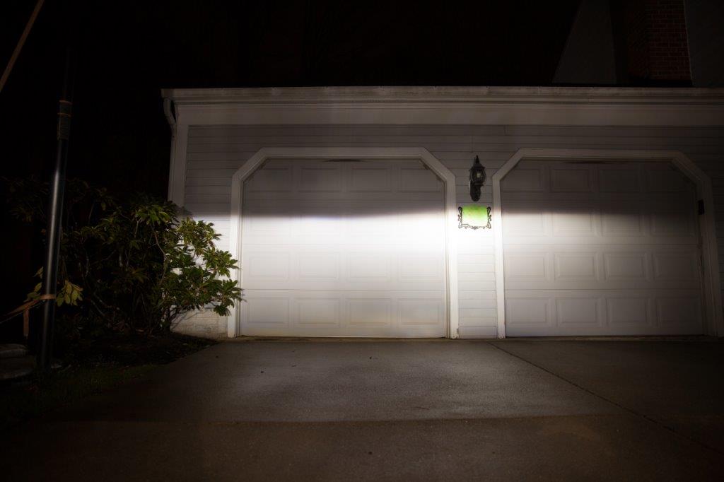

Fifth is the new Xtreme LED on the driver side, original LED on the passenger side and exposure is auto corrected. You can start to see the bigger hot-spot on the driver side due to the LED's facing straight out to the headlight lens.

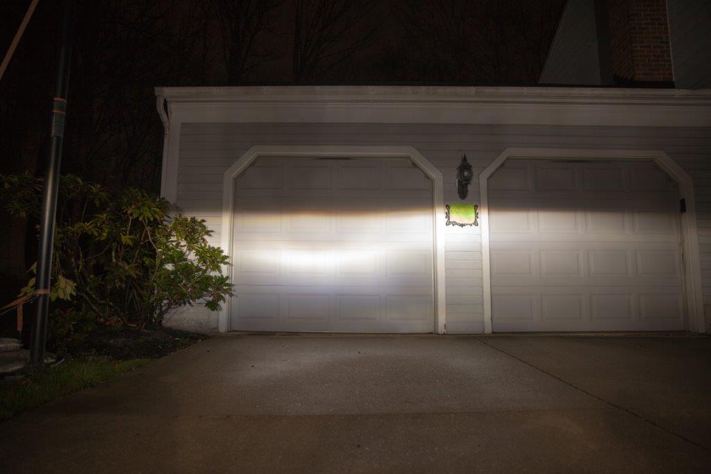

Sixth has the new Xtreme LED on both low beams, also auto-corrected for exposure. Now you can see the full "hot-spot" from both headlights.
