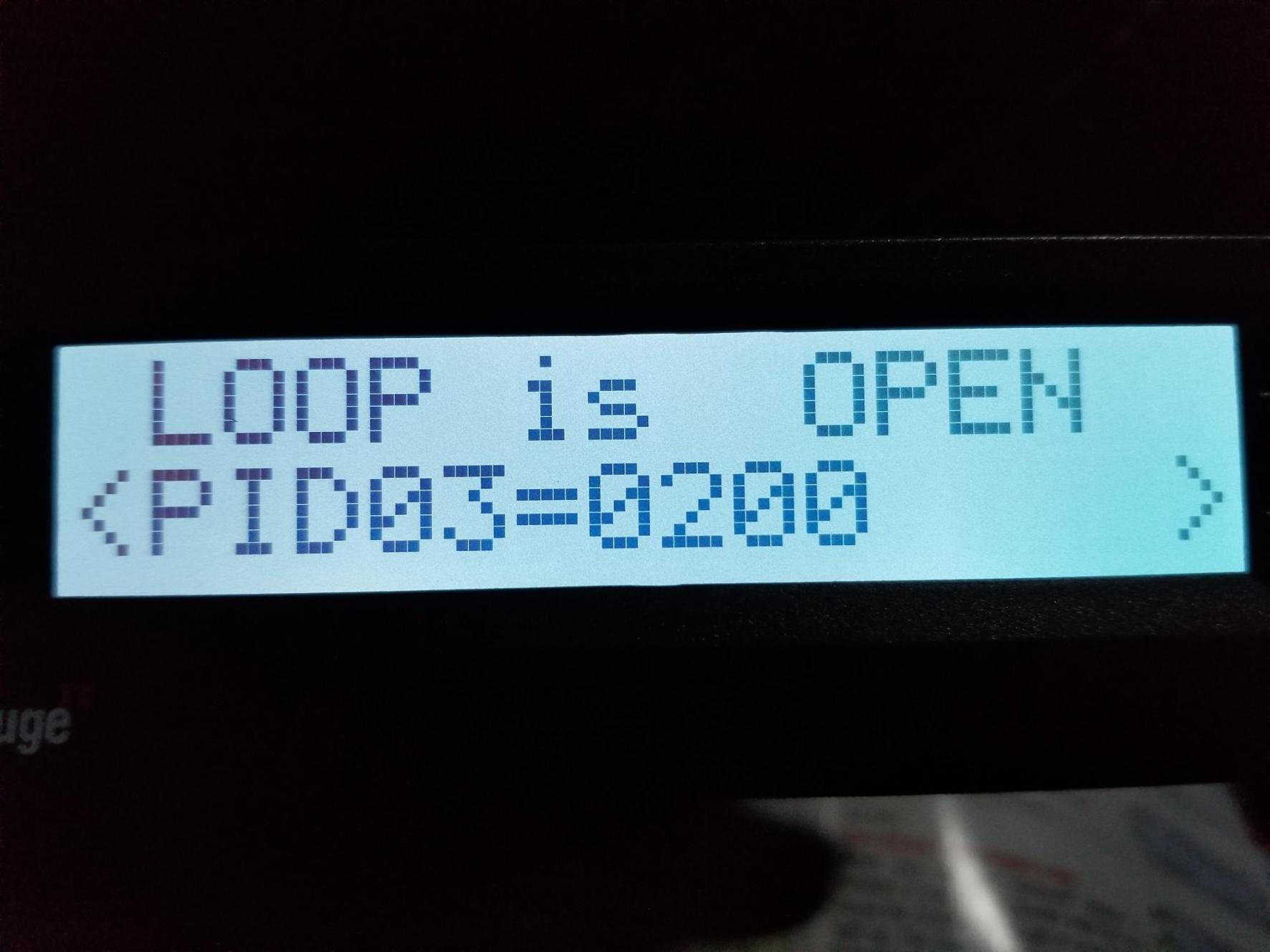

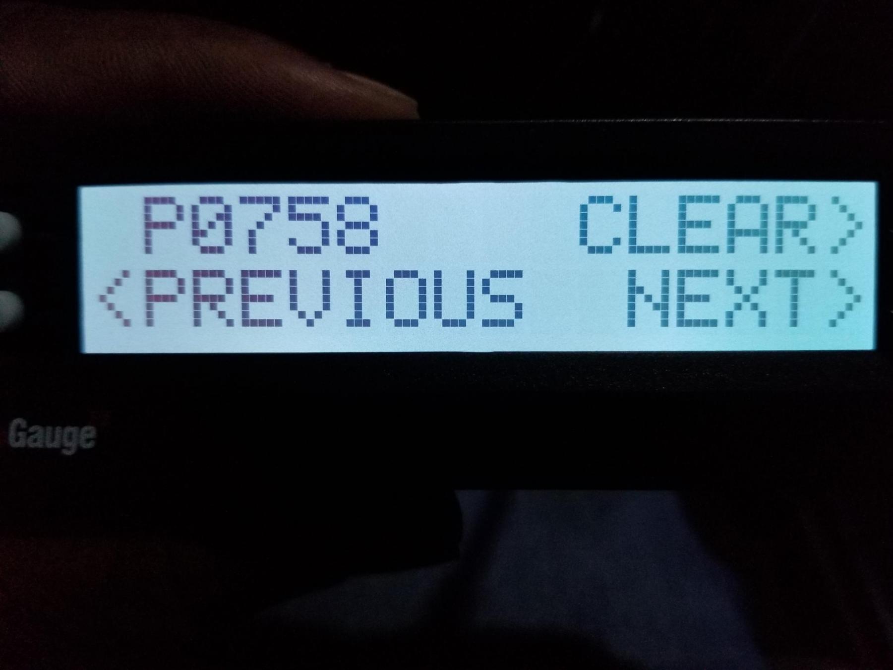

Yaaay new CEL codes for mee!
giguchan
Senior Member
This time i'm hoping it wont be too bad...
Any know of a good 3G Tech Long Island NY?
Not looking for cheap... just a GOOD!
When was last time trans fluid was drained/filled? If over 30K, I'd start there, reset codes and drive again.
Real nice looking Rig!
The first dealer(dealer maintained since i drove it off the lot in 97') i took it to did the Transmission service to it. around here the dealers don't like to work on older trucks..
The indies are just as expensive.
thank you
hey there,
Thanks for the reply. solenoid B? i'll do that.. I believe there are 3 of them i had one replaced about a year ago..hope it didn't go bad.I wish i was like some of you guys with space and friends who seem to have lifts in their garages.
I remember i had the 4WD go out on me while i was in some snow fooling around- then it too quit. it was another Solenoid.
If you end up changing the solenoids, best to stay with Toyota parts. They are kinda important. It's not a hard or time intensive repair as it only involves draining the transmission fluid, removing the pan, removing the filter and then replacing the solenoid in questions. One wire clip and one 10mm bolt and it's out.

With the current issue im hoping it's a solenoid that the dealer missed. this time it's going to a Trans place.
Might you have a reference on where i might find the Part numbers for them.. i would replace all 3 if i replace one.
** i think i found PN'S thanks.
