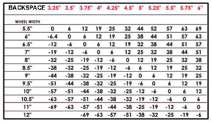

Hey was wondering if someone could tell me approx how much more these wheels will stick out compared to my stock split spokes. I thought it would be a good amount and I could maybe ditch the spacers but the guy at discount said only about a quarter inch. Is this true? Even with the negative offset? Staying with 16inch BTW.
American Outlaw : Z-Spur (S101)
Nevermind here is a great table. It would be 4.25 and probably be close to flush with the flare.

Oh cool I wish I saw that chart earlier. So according to that I guess it is about a quarter inch. So only a quarter inch more room for the UCA's and my front tires will still look too narrow.. have good amount of lift up front. Maybe I can just run spacers in the front. This is frustrating... not sure if it is worth buying new wheels...?

No problem. I have lX450 rims (4.5" 16x8) and 265/75/16's and they are about .4" from the edge. I think you should be good with those rims since you will be gaining 1.4" due to the extra 1" from the rim width and the .4" from the offset.
Yeah that's true they will be wider sticking out plus less backspace. Forgot too tho that I read 8 inch because of being wider can go into the UCA's even with less backspacing... ugh. Making my head hurt.. maybe I'm over thinking this a tad.. haha.
