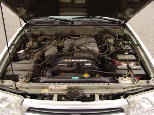

I'm looking to buy this SR5 this weekend. Does this under the hood pic seem a bit scary? Is this something I can clean up, or is it just because it's been a Massachusetts dwelling runner.>? THANKS!

Dirt doesn't scare me, Just rust.
Yep I looked closer - what looked like dirt is some rust. No idea on what to say since I live in the South and don't fight road salt. You need someone to look underneath - rust down their is a lot more of an issue

Leaking rear axle seals, bad lower ball joints, and strawberry milkshake are the three non maintenance killers for the 4 runner. Check the fluids and look under the oil filler cap.
Negatives:
1. The rust is everywhere, including the clips to the air filter and on the fuse box. Rust Aid, found at the Home Depot, would help clean it up. How the undercarriage looks is the key. Ask Nelsonmd.
2. The coolant resevoir cap is off.
3. Is that a new radiator I see or a bad camera shot.
4. The brake fluid came with the 4 runner over from Japan.
5. There is a big WARNING sticker by the AC sticker. Never seen that.
Positives:
1. There is a sticker on the timing belt cover saying the belt has been changed I think.
hmm.. you have a keen eye. how helpful. do you think that coolant cap off means it was flushed and replaced.. could be a good thing? or most likely.. a "pink milkshake issue?" hm. From what I've read around these forums, I can address that issue fairly cheaply as long as i know it was/is an issue..
:iagree: You can look at all the pictures you want and read all the carfaxs you can but it all comes down to, how bad do you want this one, are you willing to travel just 50 miles to look at it? If not I'm sure someone else will. When you go look at it and it turns out to be a bone, you might find one on the way that is even better.
That WARNING sticker is most likely for a Remote Starter.
Blue sticker on top of radiator should mean it's a new one. The coolant over flow cap probably doesn't stay latched anymore or when they did the Rad they never latched it back down.

Also... new radiator, that makes me happy.
