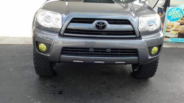

That'a what I did. But I bought the role. $7 from ebay. However, I can see fine cracking from the heat. I will have to reapply every year.
I like this look..a lot. Thanks!

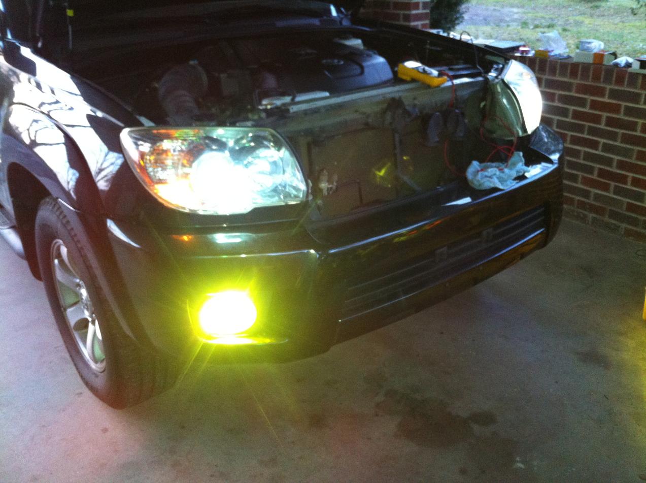

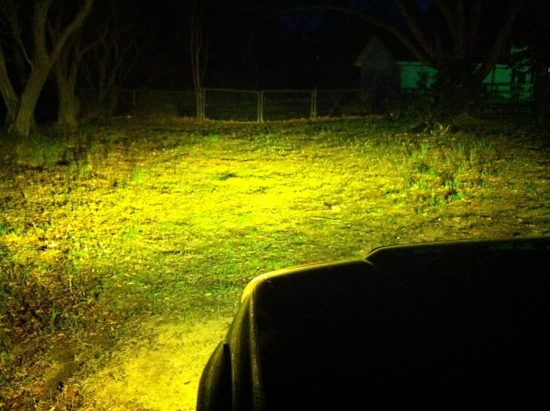

here are my fogs with hids 3000k. These are from theretrofitsource.com I highly recommend these guys.

I admit, mine is for cosmetic. Love the look of it. And the yellow bulbs don't give the same look when they're off. As far as light output, I'm about to put a lightbar hidden in the grill.
The 5000k/3000k combo is the shit. Got to test the true capability of the 3000k fogs last night in bad weather. Wow.
I like the osram 66240 CBI at 50w ballast, really white and no hint of yellow, i think its close to 4700k atleast. 35w setup will be the normal 5000k. In the aftermarket world, some brands have 2 different color at the same kelvin rating, that why i suggest you guys to see a real oem setup of 5000k and compare yours to theirs. But no doubt i got alot of light with 3000k fogs on with my retro. I just leave them off as too much light upfront will decrease your distance viewing. Plus if you have some 4100k-4300kbulb (oem philips/osram) warmer white color will have the most light on the road. 3000k with the warm white is even more light with my setup, i tried both, i use the regular bulbs as spares.
