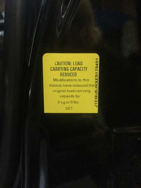

Yellow sticker in door jamb ? (Factory modifications)
2014 Limited
No all weather mats
+ running boards (I removed them)
0lbs/0kg

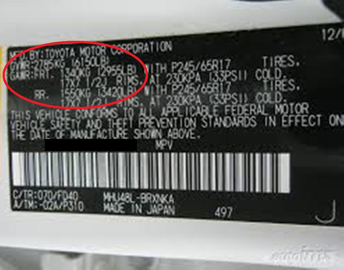

Looking at your driver’s door you will notice VIN tag, it documents Vehicle Identification Number, GVWR (Gross Vehicle Weight Rating) is the maximum amount of weight vehicle is designed to carry……….actual weight of vehicle (full of fluids), all occupants, and cargo. GAWR, Gross Axle Weight Rating front and rear, is maximum allowable weight for front and rear axles. Additional information is also documented e.i. rim and tire size, but not going to elaborate on those at this point. All of these capacities have been designed and engineered to allow for safe operation.

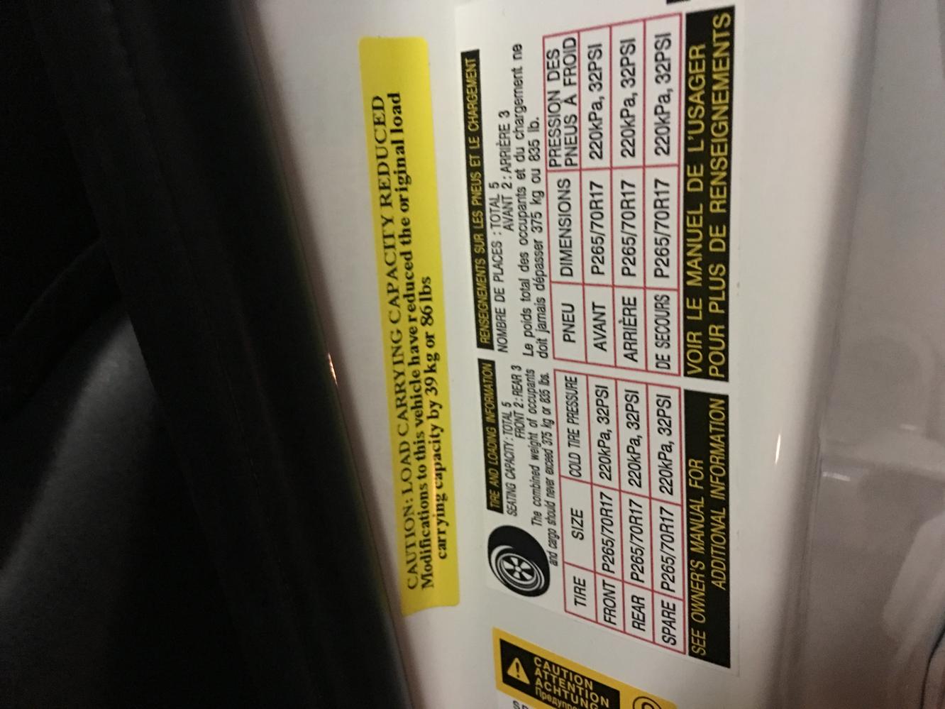

Mine
I guess mine is from the trd wheels.

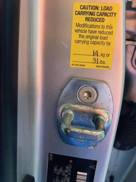

134000 miles and I just noticed this sticker for the first time.:biggrin1: '10 TE, no KDSS or other options, so I am assuming it is for the slide-out cargo tray.
