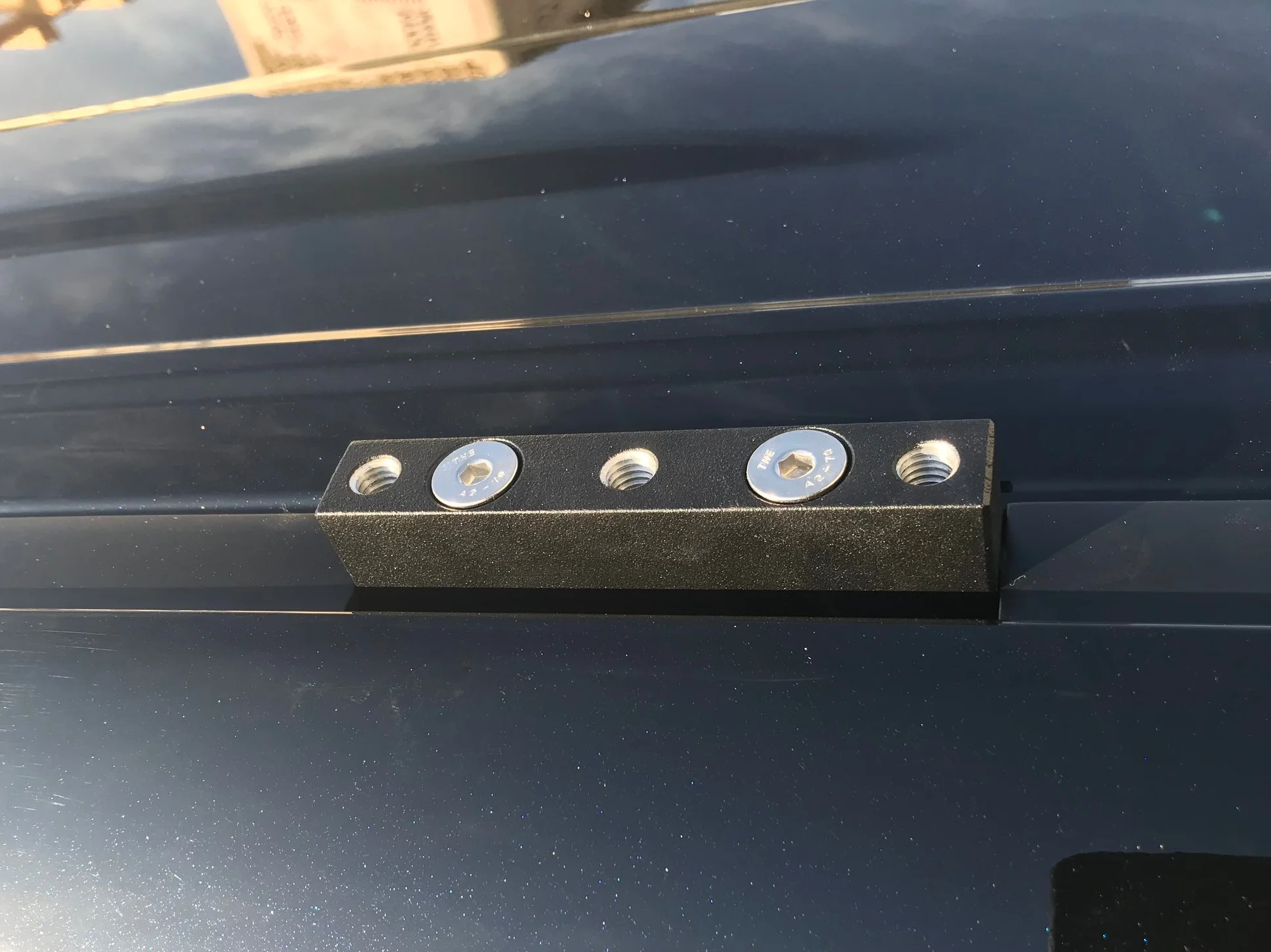

Isn't greenlane's approach actually better sealed/protected than sherpa's?
Please explain or link to the Greenlane sealing approach.
After reading many threads and some posts about silicone sealant failure I thought the use of butyl rubber was the best material.
4Runner Aluminum Full Length Roof Rack System — GREENLANE OFF-ROAD
https://images.squarespace-cdn.com/...RKOCd3Esfzua9QhbWww/IMG_1332.jpg?format=2500w
-Gutter block system allows a much larger mounting footprint as well as allowing you to remove the rack without unsealing your roof
Their install does use silicone, but the way their mounting block works it seems to offset the screws so its more protected, and spreads the load better? Plus can remove the roof rack while keeping roof sealed.
Orrrr that's all marketing speech, I am not an expert :)
My top choices are Sherpa or Greenlane right now, it seems. For me, at least, Greenlane is local while Sherpa isn't and driving across the border to save delivery+duties isn't really possible right now. Something something covid
did you have pull the trigger between these two? I'm down to Sherpa or Greenlane as well. Just can't a lot of details or info on the Greenlane.
