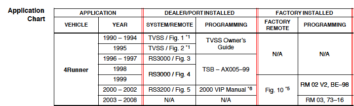

There is a manual in the glovebox for the rs3000 so i'm pretty sure it's the rs3000... could this be wrong?
Also, if you see the Toyota Bulletin here... www.97supraturbo.com/Tech stuff/RS3000.pdf it shows that I have the "factory" installed rs3000 (fig 10). It also shows fig 4 controller which is NOT the controller I have. I have the 3 button controller shown in fig 10.
Am I reading this correct?
Now just trying to figure out how to reprogram, reset ECU or lock/unlock sequence.

Having the manual in the glovebox doesn't prove anything.
What year is your runner, and what trim (base, SR5, Limited)?
If your remote looks like the one in figure 10 - you have the factory installed system....which is not the RS3000.
There is a chance someone at the dealership tossed in a generic RS3000 manual when you bought it. There is also a chance that you have the RS3000, but the wrong remotes...which just so happen to be configured to lock the doors...which is highly unlikely.

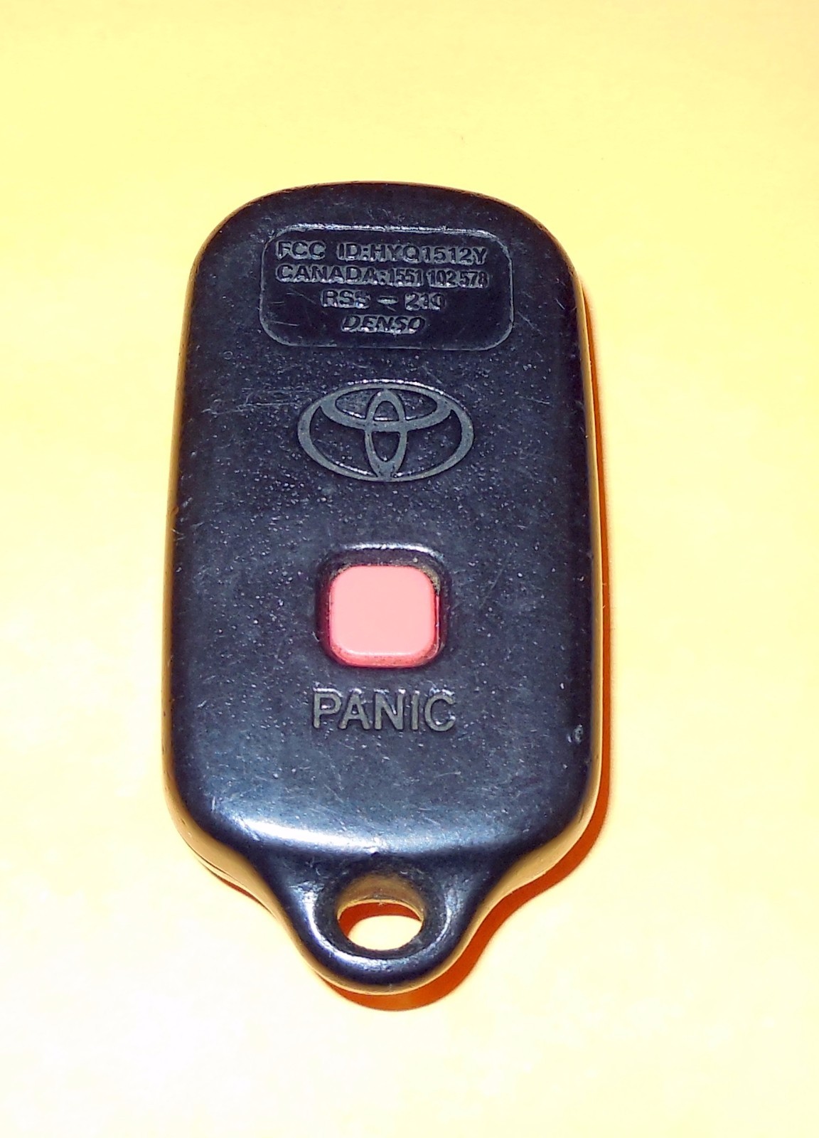

Runner is a 99', SR5.
Remote looks like fig. 10. Bought from Private Seller which is why I assumed it was legit...
Also, I have physically looked for the ECU under the driver seat, around fuse box, kick panel, etc., but was only looking for it if I needed to push reset on actual alarm ECU unit to reprogram...
Sounds like I have the factory system.. if so, do I reprogram the key fob by the lock/unlock sequence? I've done that 20 times. Pretty sure i'd of got it by now. I get stuck at step 6b, cycles twice. 1999 Toyota 4Runner - Free Keyless Remote Fob Entry programming instructions, procedures for all automotive vehicles
Might be the remote...? If so, just ebay for FCC ID 1512Y? Then lock/unlock sequence to program?
Key fob can only lock right now, no unlock or rear window.
Thanks folks.
Yup, I'd try a different remote. Scan ebay closely - some are in better shape than others. Plan on buying a new battery for it as well.

Another quick question now that I'm looking, is the FCC ID HYQ1512Y for my 2002?
I got that ID from another thread about a 2000 SR5 and I wasn't sure if the fob ID changed over the years.
According to my research on the subject that is the correct fob ID.
Also yes once completing the 5 key on key off sequence you'll get a lock/unlock from the car to let you know it has completed and cleared out any programming memory
Quick update: I got a used OEM remote off eBay for $25 and everything works as it should. Aside from the window function now working, the physical remote feels more robust than the aftermarket one off Amazon - the buttons have a much more positive click to them when pushed.
