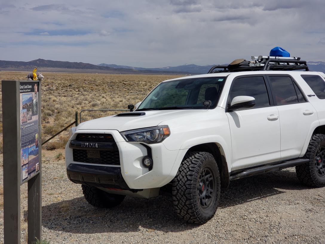

Installed the 285 70 Duratracs, load D
Fit fine...minor rub that i fixed with heat gun, no trimming required.

Looks good. The duratracks in that size and load rating is probably the next tire that's gonna go on my truck after the KO2s wear out.
Surprised you have no rub, especially with the front flaps. Mine weren't even close to fitting with the flaps on. Same wheels as you.
I have the newer fox shock upgrade the TSB where they replaced the coilovers with the 21 version. I did not take measurements before, but they definitely sit a little higher than the originals (maybe because they are new...maybe that is not even a factor). They are definitely close though.

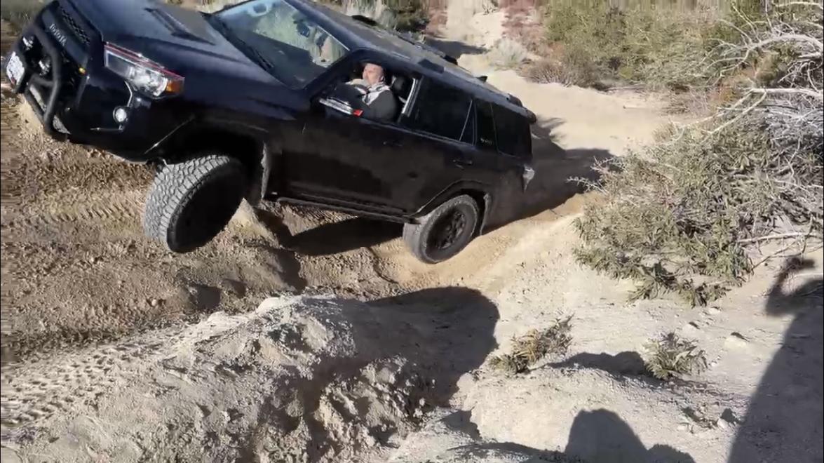

I added 1.5/1” Cornfed spacers to my stock Pro and did no other mods whatsoever with my 285’s and only slightly rub at max articulation in certain situations.
