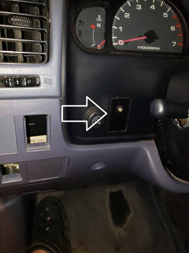

Trying to figure out if my son's 2000 4runner has keyless entry. Changed all the actuator motors this weekend in hope I could finally program a couple of fobs. I did the steps nothing. Someone mentioned to me that if I had a little security light, that meant I had an alarm and should have keyless. Messing around yesterday I popped the security light out and the wires had been cut.
So does that make the system not work? I tired to find the wires to it but can't, where is the keyless entry/alarm brain located so I can find it and see if it's hooked up.
Why would have someone cut the wires?

Thats a light for the alarm system. Check the driverside kick panel there maybe a aftermarket alarm box there. You will know it's aftermarket by the crimp wire connectors.:cheers:

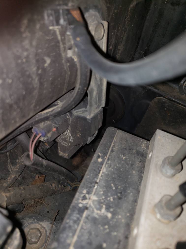

On a 2000, factory keyless entry was built in to the Body ECU. Alarms, whether factory or after-market, were add-ons. The only visible evidence of factory keyless entry is the chirper thingy, located on the inner passenger fender wall, way back towards the firewall.

Is this the Chriper?
