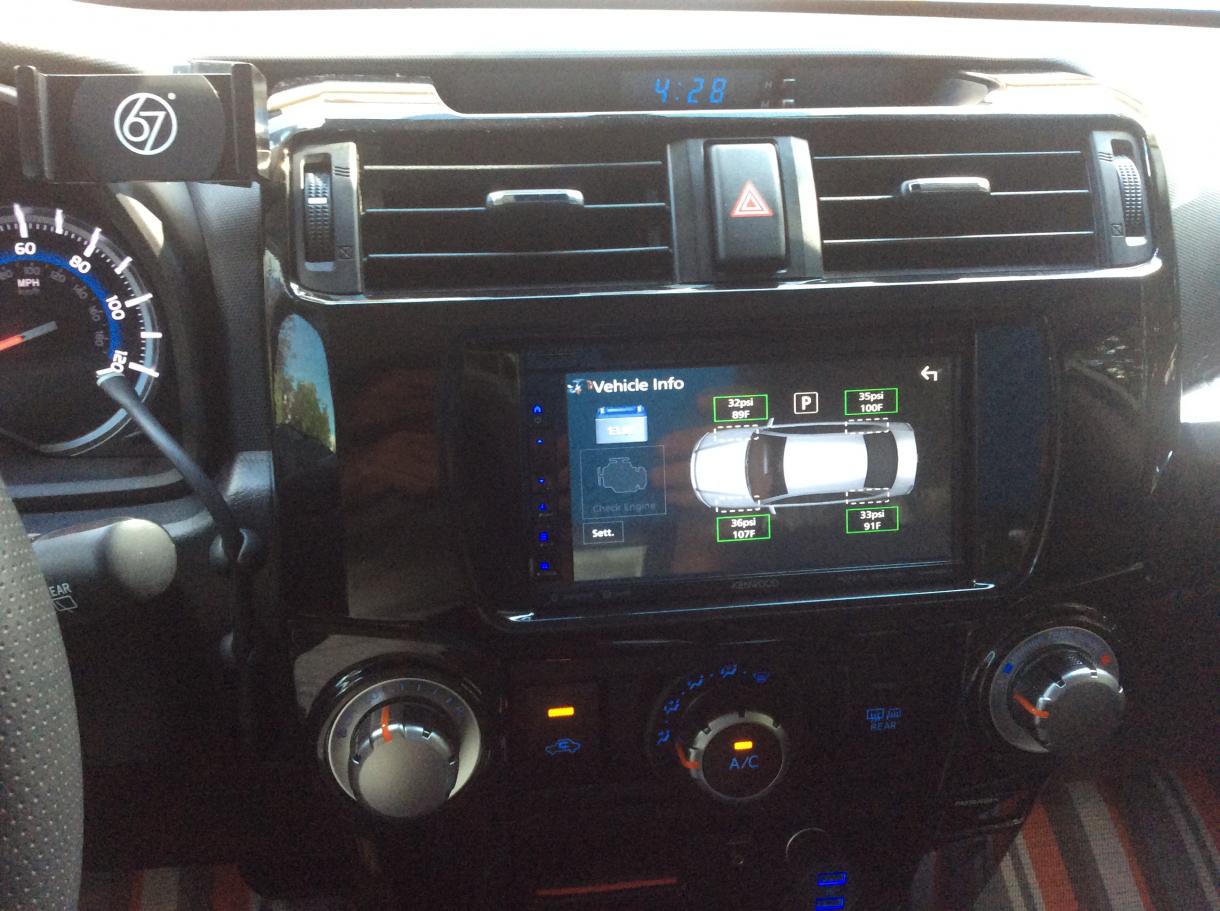

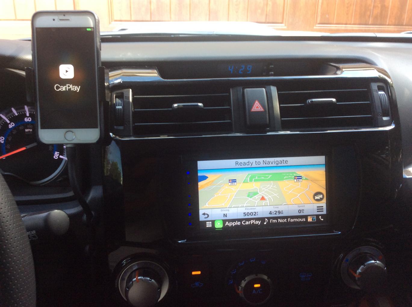

I bought USB ports that are designed for the OEM switch openings, placed the Apple Car Play one directly below my phone mount with an 8” cord. I placed the second one in the factory location in the lower console. They also didn’t mention I would need these.
It also does so much more than what you are wanting. You can even program in opening your windows with the key fob or key. Tire pressure is awesome. Nav is sooooo much better. Etc
