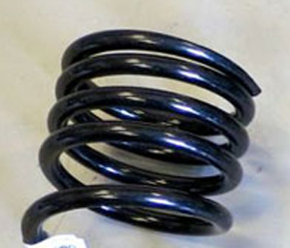

Should I have trimmed the spring the the Toyota ones? (attached example image)
What did you guys do when you guys did your suspension upgrades? Where the springs trimmed or did the strut mounts have this kind of slot for the spring to fit?

No, the rubber top mount is just a solid flat ring. The top of the spring should be flat just like the one you show pictured on the bottom, to fit flush on the top mount. Youre saying the moog coils are rounded on top, like the coil youre showing in the top picture?
Yup, the top of the spring is not flat and does not mount flush with the with the strut mount.
Huh. Well in that case, I would say either 1) moog makes their own top hat to go with that coil or 2) they skip the step in shaving the top of the coil to save some time and money. Probably the later.

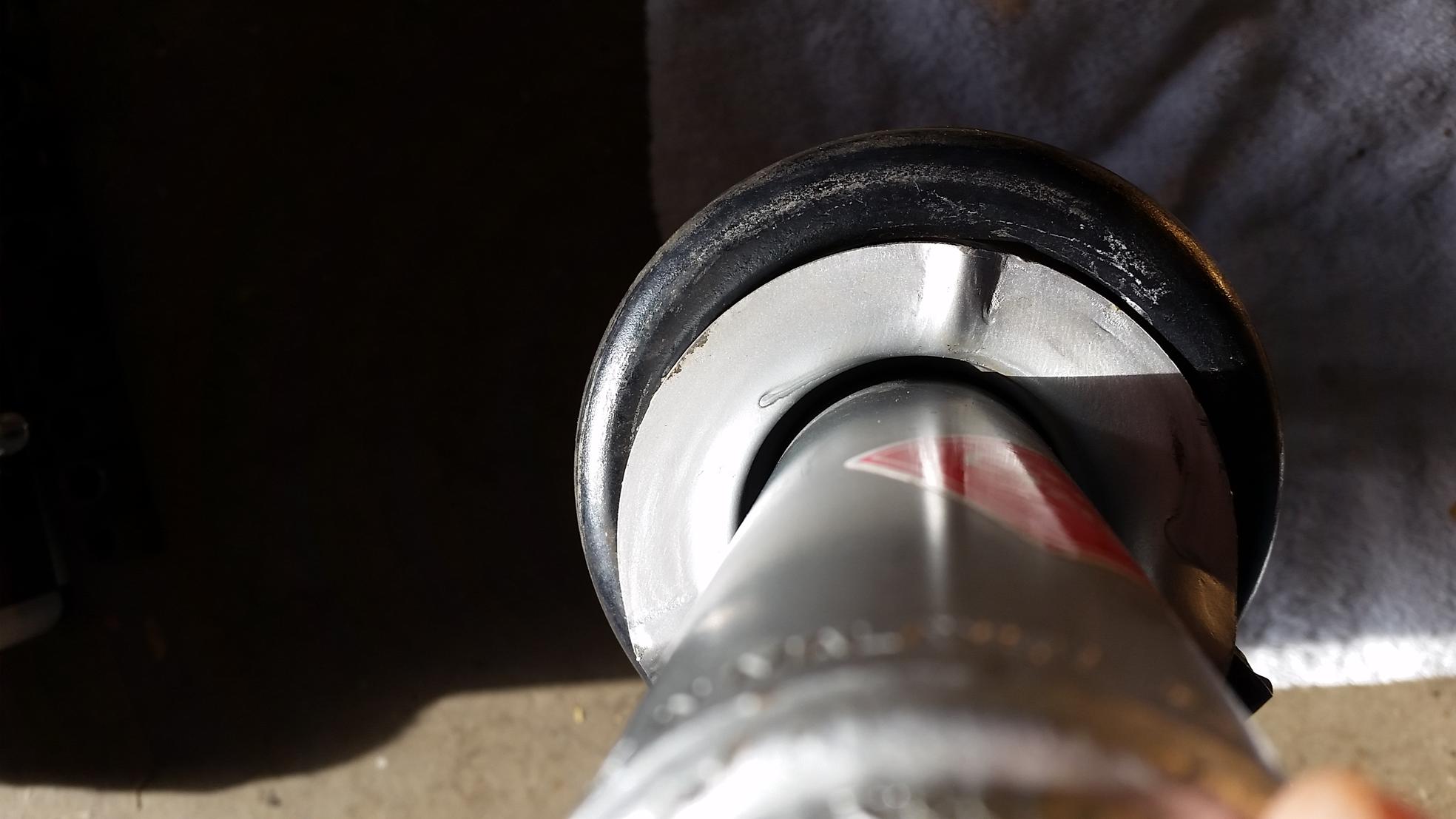

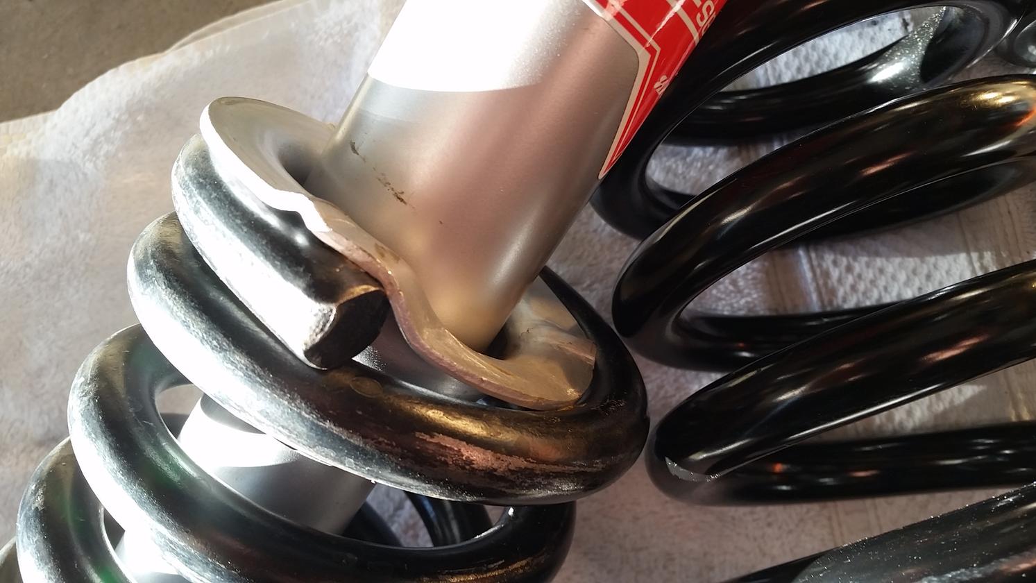

So I am taking a look at the struts and had a couple of questions. The coil spring I am using has one end with a smaller diameter coil. I would have thought that the smaller end would go on bottom and match up with the bottom of the strut assembly however the shop that built these for me put the smaller end on top. Is that right?
It looks like the spring might be rubbing on the bottom of the strut (picture). Could that be the source of the noise?
I'd take them apart to find out however my spring compressor (even the skinny Harbor Freight one) one fit between the coils so I need a shop to dismantle and reassemble. Before doing that I wanted to make sure this was wrong.

Wow. Yes the shop installed those upside down. Not only is that wrong, but its also dangerous in my opinion. The end of the spring could slide down over the bottom perch. The person who did that needs to be slapped in the face with a chair.

Yeah, I took it out and went to the shop. The owner took one look at it and said he would fix it for me right away. Got back, installed and life is good. Rides smooth as glass and no squeak.

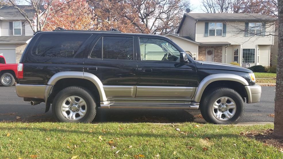

Good deal. Glad you got the suspension worked out. Any chance you could post a side view picture of your truck? I'm curious to see how high the moogs sit compared to stock
I held off on taking any pictures because I wasn't satisfied with the rear height. Since I installed the new Moog springs about a month ago they are now beginning to sag more than the original suspension that was 13 years old. I contacted Amazon returned the springs and instead purchased some 99 oem Springs from toyota. They were a lot more expensive but I'm happy with the results.
36" in the rear, 35" in the front (measured from ground to fender. The Moog had actually sagged to 34.5“ in only a month. No weight in the he back of the 4Runner.
