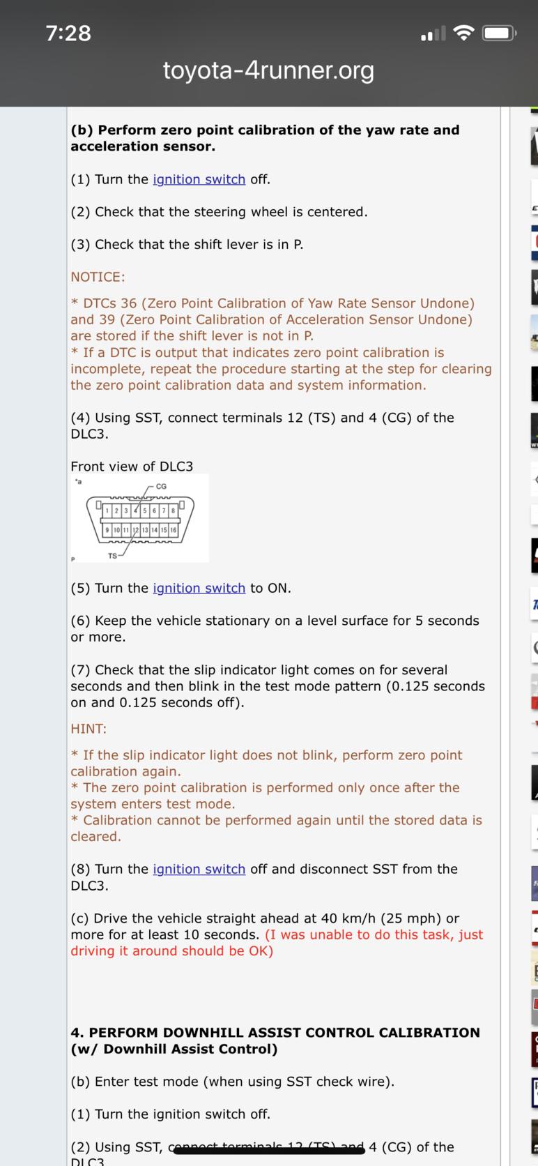

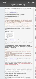

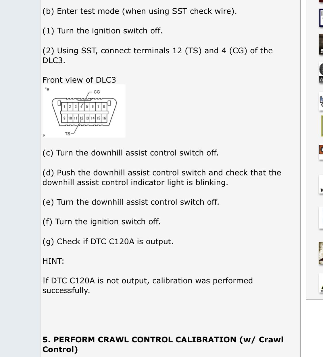

Hey all. I had the adjustable 5100's put in up front and, of course, my abs/etc is now buzzing a bit at low speeds/etc. I found out that I need to do a zero-point calibration and the instructions seem pretty straightforward EXCEPT when you get to the part where, if you, like me, have the crawl-control, you need to do a bit more. See the instructions below and see why I am confused. If you look at the first image (perform zero point calibration of the yaw rate and acceleration sensor) you can see where it shows to turn the ignition switch off, then on, then off. All good. BUT, when you go to the next step (step 4, Perform Downhill Assist Control Calibration, the first thing it says is turn the ignition switch off, connect the two terminals (12 and 4) and then turn the downhill assist switch off (why would it be on, the ignition is still off), and then next it says to turn the ignition switch off...but where did it say to turn it on!? This is why I am confused. Is it obvious...am I missing something? Thanks!

Thanks for the thoughts but I figured it out. First, yes, I had to do it to eliminate my system from buzzing. I realized (after posting my question) that I don’t have the downhill assist control, I only have crawl control. So I could ignore the section that was confusing me. I did the clear and calibration, no problem. But as the first page in the instructions say (paraphrasing): ‘If you have downhill ascent control or crawl control you must do steps 4 and/or 5 or the skid indicator light will remain on’. And yes, after I did the reset and zero calibration, the skid light stayed on, so I had to do the crawl-control calibration.
glad you figured it out. yes, you have to complete ALL steps in order for the ZPC to be accepted by the system; that means Crawl Control for models that have it, and DAC for those that don't. here's the best explanation of the process for those who may still need this information...

I did the zero-point calibration last night but didn't drive much after that (was close to home when I did it). Today I drove around some more and noticed that, while the vsc is barely coming on anywhere near as it did after the lift and before the calibration, it still came on when I was at around 25-35mph, going straight, under partial throttle. I will probably drive around 'as is' for a few more days and if this doesn't improve I will just do the calibration again. Once it's done once it's easy to do again.
What really surprised me is that the person who did my front lift didn't mention this potential issue. I'll assume they didn't know about it so I emailed them about it so they can educate themselves for future lifts.
*I used 2 paper clips to make the connection and just threw them in my center console so I can do it again as/when needed. The hardest part, I find, is finding a completely level road that's long enough to drive-off and maintain 25mph+ for 10 seconds. I did the calibration at a large loading facility where the docks are perfectly level. I did it at night when there were no trucks in the bays.
