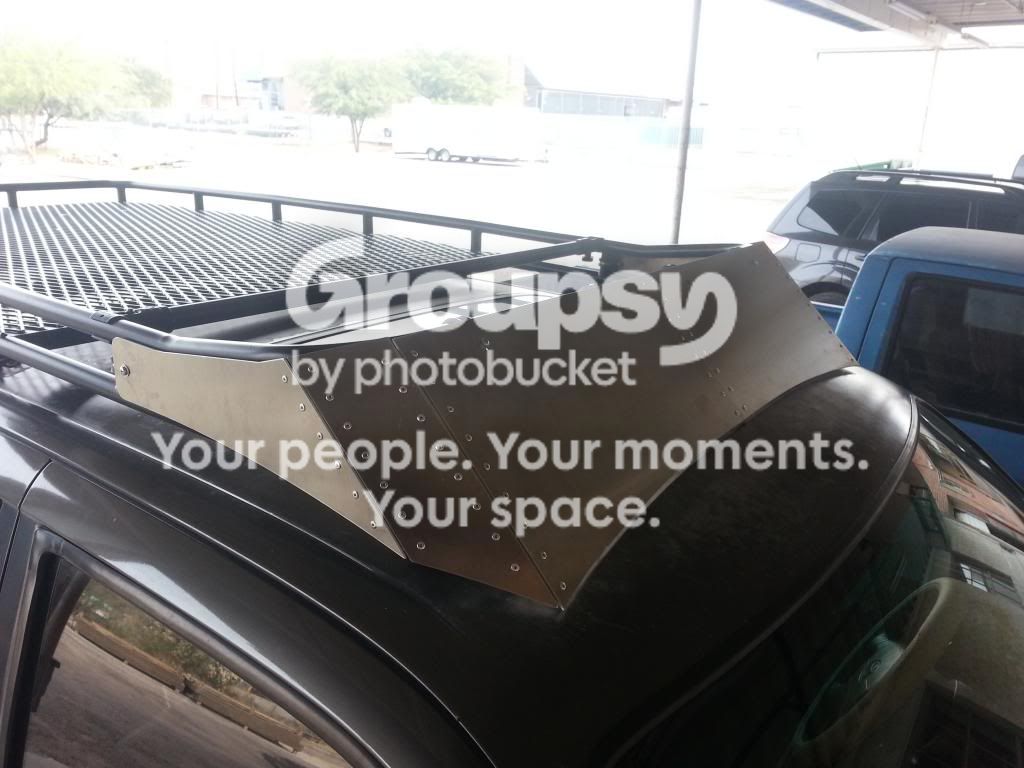

Finished the Fairing for my WMW Rack

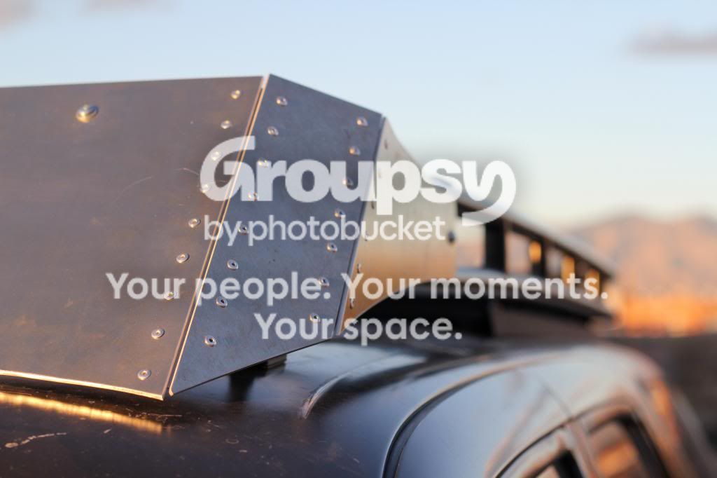

The main plates are all 0.090" 5052 aluminum, and the backing plates where all the rivets are located are 0.062" 5052 aluminum. I was originally going to use solid rivets for a legitimate airplane look, but I opted to go with the pop rivets for ease of assembly.

man that thing screams STICKERS!! haha, i love the rivets and what they add to the mechanical look. Any luck on finding an edge protector for the bottom? Is it really needed? it seems like the fairing fits very well and solidly and that movement, to the point of touching the roof, isn't going to happen.

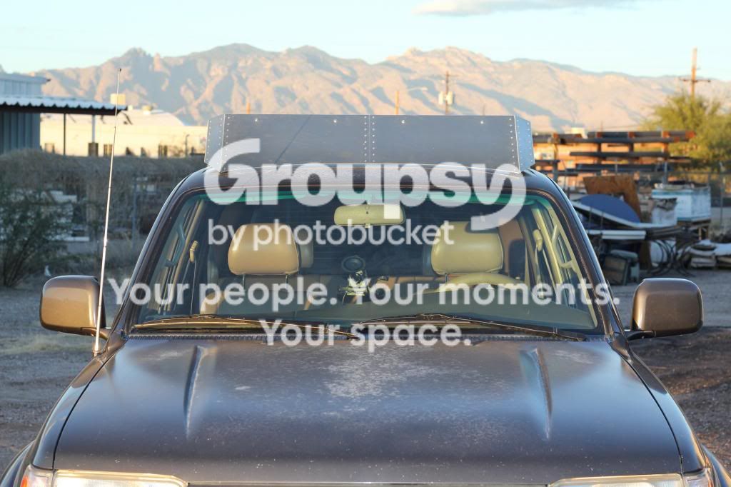

Even though WMW did a fantastic job (per usual), do you have any plans to extend the fairing back? Just because the rivets are so damn sweet looking!

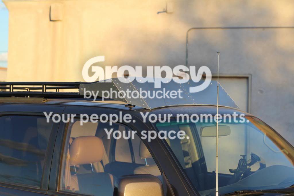

So I wasn't so much worried about the fairing moving, it's super solid. I was more trying to seal the gap between the roof and the fairing. I tried to take it on a quick jaunt on the freeway yesterday, but I only got to 65 before hitting a traffic jam.
With the sunroof closed as well as the sunshade, it sounds like stock. With it open, there is definitely a sound coming from that gap, but it's not bad. Just curious if I can make it better.

I realized I never answered your first question. No plans to extend the side right now, although it would look really cool!!

for the gap you could use the rubber pieces thaey give you with the bushwacker fender flares like this Bushwacker Part b/w000040-01 - Fender Gimps - 4 Wheel Parts

Awesome idea, that could be just the right thing! After 9 hours on the road today with no wind noise from the rack, I may have to agree with Josh and say it's just not necessary. It is kinda of annoying with the sunroof open and I think the seal would get rid of that, but you can't have your cake and eat it too!
