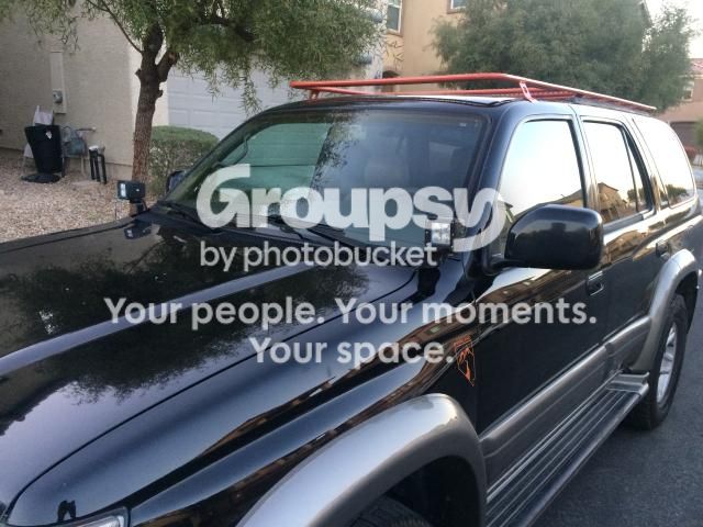

Got a couple things done last weekend while I was waiting for the last of my suspension to come in. First was CBI ditch light brackets (super nice product) and some LED Flood lights I picked up from a local friend. I also painted the cowl with some trim paint while I had it off, it was pretty faded out.
I also finished up a roof rack I was working on. Its a low profile, full length deal built from 3/4" .065 tube. I painted it orange thinking it will offset some of the black on this truck (more black is coming), but honestly I don't think I like it. I'll probably pull it this weekend if I get time and paint it black too. Opinions welcome!
