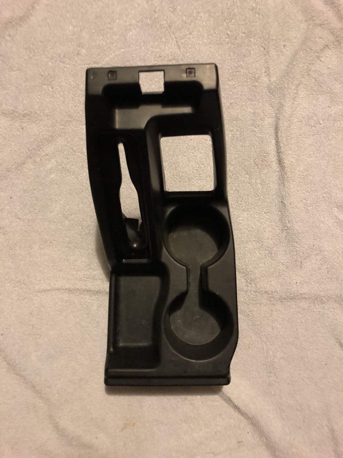

  • Late Model Center Console, with switch plate (page 5, post 69)

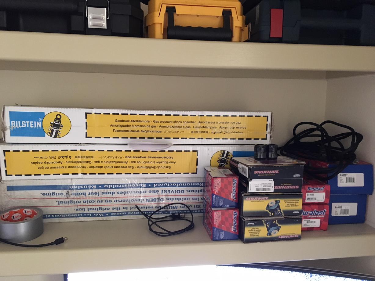

The suspension purchasing has already begun. Decided on the classic Tundra TRD/OME 890/Bilstein 5100 set up.
Bought just about everything for a complete front end and partial rear suspension refresh:
Bilstein 5100 struts (x4)
OME 890 rear springs
Tundra TRD Front coils
Front upper ball joints
Front lower ball joints
Steering end links
Pass CV axle
Need to buy: PLEASE HELP!! where can I get the full set?
Front upper and lower control arm bushings
Rear upper and lower control arm bushings
hopefully going to install this week.

I hope those Duralast boxes dont contain LBJ's. You should only use OEM for those.
Otherwise good luck with her.
any specific reason as to why? high failure rates?
I purchased the Duralast upper and lower ball joints.
Yea, anything other than OEM for LBJ's has a high failure rate. You should be fine for the uppers. It doesn't have catastrophic consequences when it fails.
Just Google "3rd gen 4runner LBJ failure" & look at the pics. I'm sure it will change your mind.
I have Moog LBJs and they are fine. Just remember to pump about 5 shots of grease every other oil change and you'll be good.
ooh ya good call on the pictures. is the OEM a TRW Ball Joint? hoping to buy this at Autozone.
43340-39465 and 43330-39585 are the part numbers I have for OEM. Can find them on CamelbackToyota.com comes to $215
havent thought of Moog. that might be a good alternatince
well, went ahead and bought OEM LBJ this morning. and returned the Duralast LBJ's.

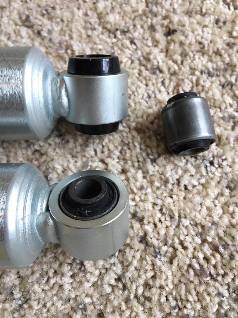

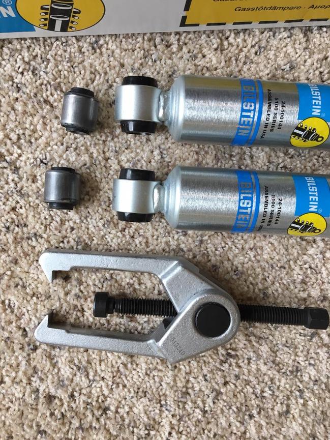

rear B-5100 tundra bushing swap to 3/4" 4runner bushing
while waiting on a furniture delivery, I managed to push out the tundra bushings, and press in the 3/4" 4runner bushings
the new bushings: Daystar Universal 3/4" ID Hourglass Shock Eye Bushing Kit PN# KU08007BK
all it took was a Tie Rod/Inner Bearing Race Puller, a washer, and a zip tie.
once the first half of the bushing is pressed in, use a tip tie and tie it around the second half. This keeps the bushing from squishing out, and will help force it into the shock hoop. worked like a charm.
a picture of during, and then after, and the tool
