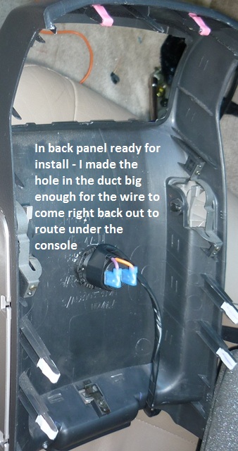

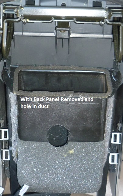

The biggest question was where to put it. There isn't really space due to the air vent duct in the back. In the end, I just decided to let it intrude into the ducting. Here are some photos. I ran the wires under the center console and put it on the cigarette lighter circuit. Note that the back plastic for the console pulls up and out. You really don't have to remove the console to do this.

To address the air duct being intruded, could you not intall it on he duct, and fit the cover over it, then close it? that way, you could seal it using, say, automotive grade silicon, and there would be no AC leak... Air would actually come out a bit faster, too.
Great idea ! ! :wink2:
I dont have a 110 plug in my Sport and I have been thinking of where to put one. I really like this location and did not realize the ease of access.
You have to love this forum and the inspiration from everyone.
You could probably do that but it would be tricky getting the outside hole drilled exactly right and if the hole gets dinged up, the mounting ring wouldn't cover it. It'd be really easy to make it look bad instead of close to factory.
could you apply the silicon before reinstalling the panel?

Did the outlet you bought on amazon come with wires or did you use your own? If so, what kind did you use?
No wiring included but the outlet has standard 0.250 male spade connectors so you just need a couple of female ones to connect to it. I'm guessing but I probably used something in the 18 gauge range for the wire.
