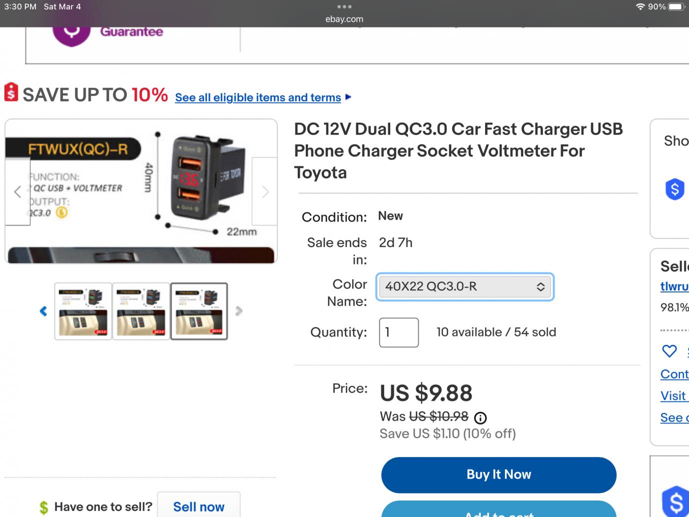

I just installed one in my 4runner as dual purpose volt meter and usb charger. 40mm x 22mm in red for older toyotas. Red is easier on night vision than other colors. Well worth $10 and 30 day shipping on a slow boat from China. I Used an add a circuit 10A and fused it on its own 14-16 ga + wire. I popped into one of the blanks on the center console. This uses Qualcomm tech to prevent overcharging and promises rapid charging. QC3.0
DC 12V Dual QC3.0 Car Fast Charger USB Phone Charger Socket Voltmeter For Toyota | eBay
3 Pack Micro2 Fuse Tap + 10A Blade Add-A-Circuit 10AMP Adapter Micro 10 Amp 12V | eBay
