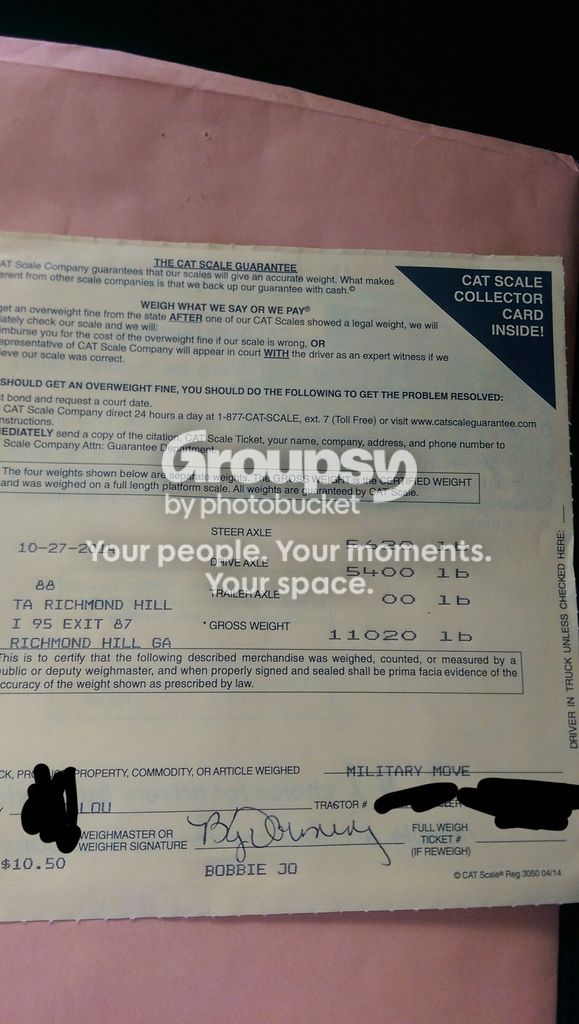

Here's my weigh ticket from my move earlier this year the weight is distributed. Check out my build thread for more info.

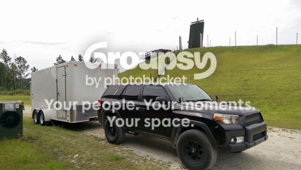

I use my enclosed trailer 3 to 5 times a week for work. It's 3000-3500 lb some times more, on flat roads it's easy, keep it in 4 sport mode you will be fine. Speed is a big issue if want to go fast 60+ mph you will hit a wall from the lack of power just be patient you can't rush. lol
