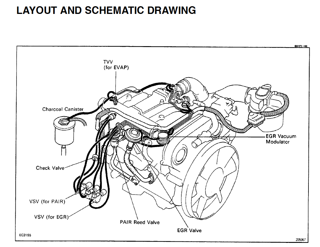

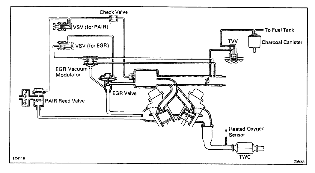

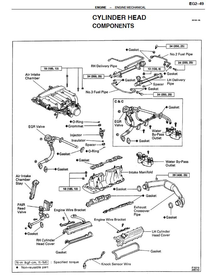

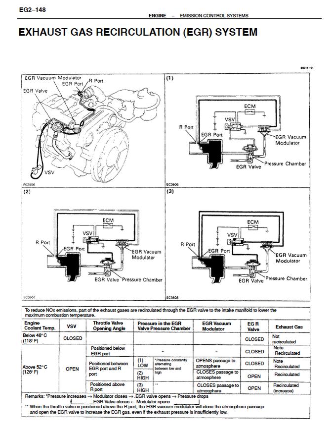

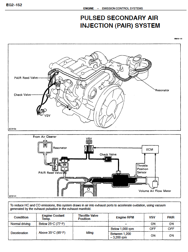

Does anybody know where i can find a diagram of where those plugged hoses go?
burnera is offline   Reply With QuoteReply With Quote

Hope this helps.
Here is a link to the portion of the FSM that corresponds with the pics below.
https://www.dropbox.com/sh/93p954g9ek5321c/dxXkW-7NWE
Here is a link the entire 93 FSM.
https://www.dropbox.com/sh/c0xui5y9neu2oht/oc4FM1rjRP
One Problem at a Time.-screen-shot-2013-06-22-9-24-25-pm-png  One Problem at a Time.-screen-shot-2013-06-22-9-24-32-pm-png  One Problem at a Time.-screen-shot-2013-06-22-9-25-17-pm-jpg  One Problem at a Time.-screen-shot-2013-06-22-9-26-05-pm-jpg  One Problem at a Time.-screen-shot-2013-06-22-9-26-35-pm-png
