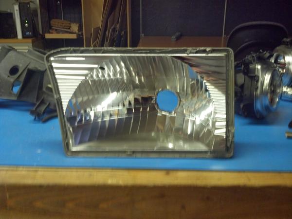

Reflector with glass and center piece removed I used a heat gun on edge and a razor blade then a wide chisel to pry it open, Sort of a pain but Once
