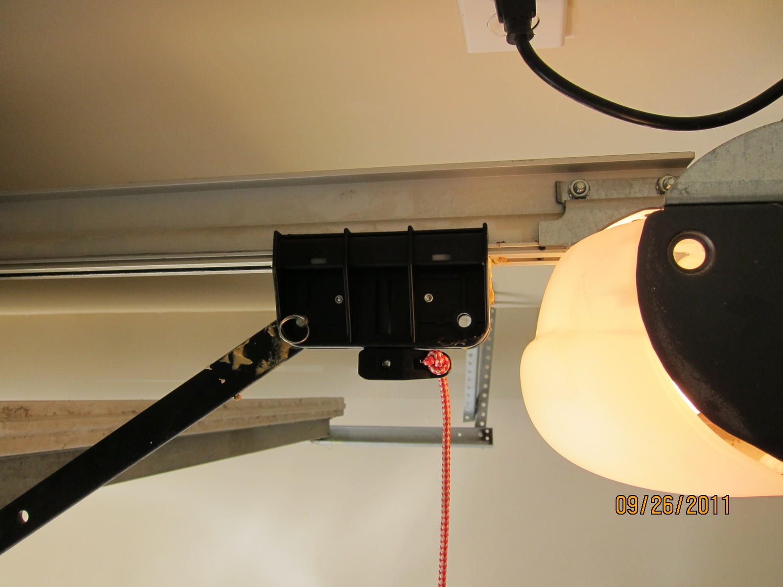

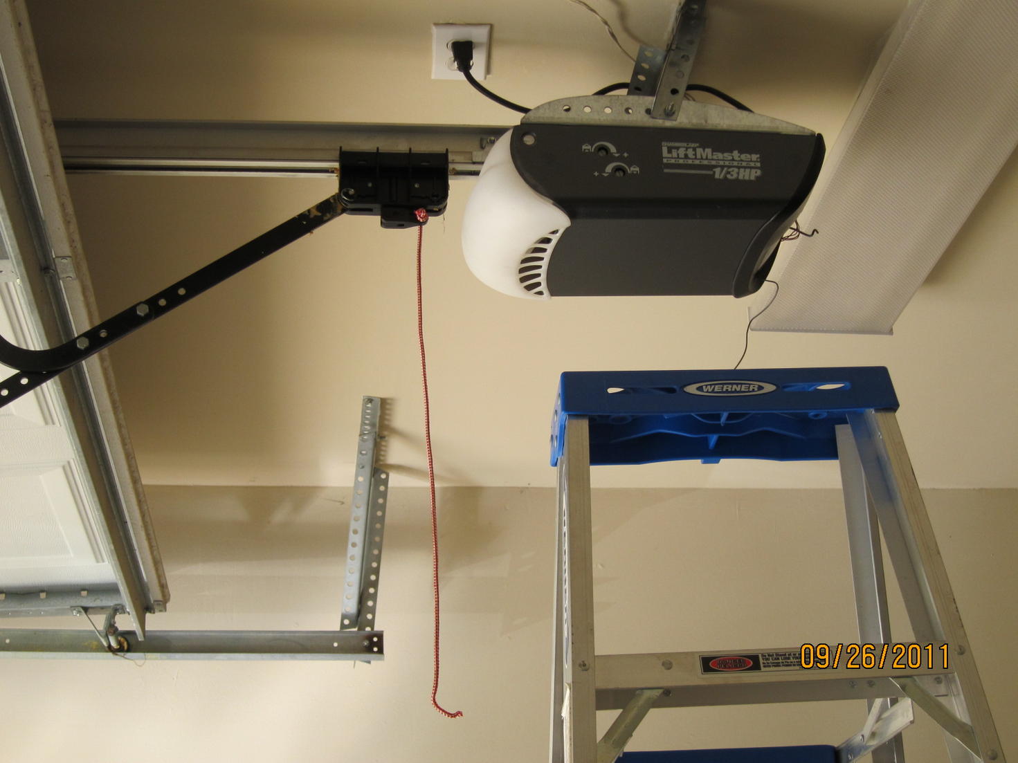

Well, i just examined my garage door. At least for my garage, the release handle is flush mounted against the slider...so, there is no gap for any hook to get into. What i did then was to take out the handle at the bottom of the string.
Thoughts? Am i safe?

I think so, at least much better than before. But like you and others mentioned nothing is going to stop a determined pro who is willing to either break a window or drill a hole, etc.
I have the other style release in which I needed to cable tie it up so it cannot be moved with a hook/hanger. Also I blacked out the windows with these...Blackout EZ Window Cover. Nice quality for the price and can be easily removed when working in the garage for long periods and you want some natural light.
One thing I often hate about my garage, no door inside the garage to the main house, can be a benefit in a garage break-in of these sorts.

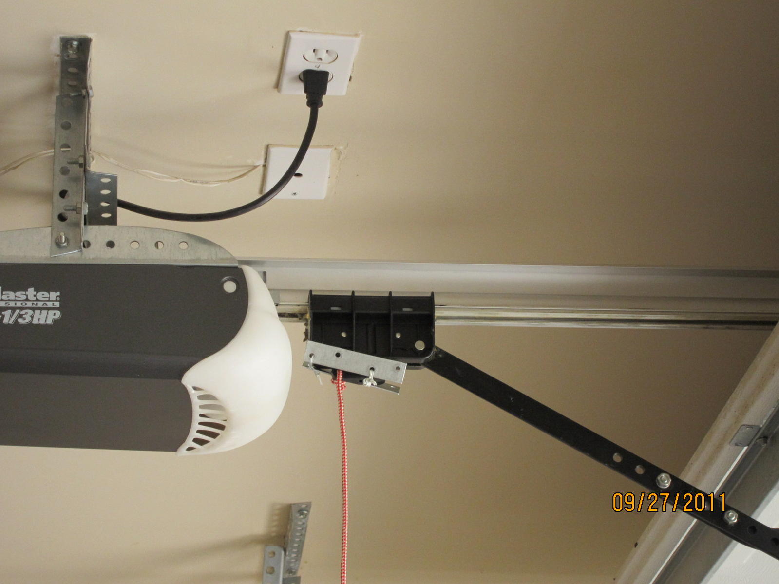

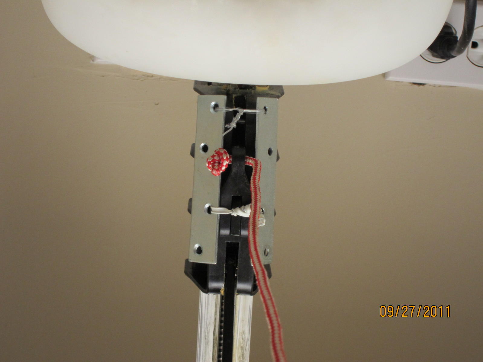

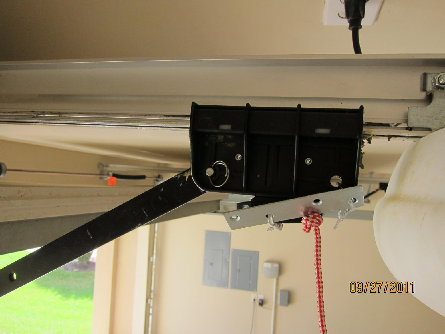

This is what i did today...bought 4 inch metal "mending plates" (4 quantity) at Walmart, then use zip ties to connect them together. With these plates attached to the sides of the slider (or whatever you call it), you can still pull down the release handle and push it back up. At the same time, it blocks any hooks from getting into the critical space.
