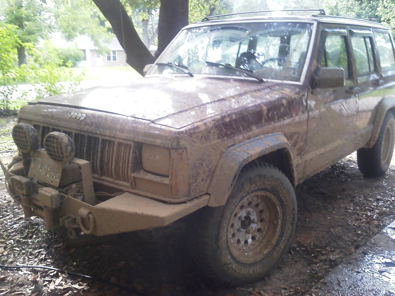

Couple pics of the heep and "wheeling buddies" from highschool. and a shot of the 4runner. Didn't realize how few pictures I have of the runner, don't even have any of it with stock wheels and running boards. I'll have to fix that.

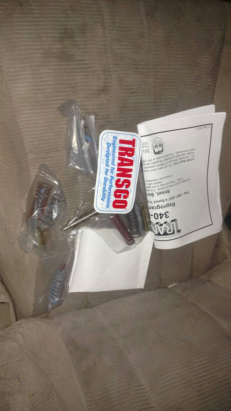

UPS guy dropped off some goodies! [emoji16] uploadfromtaptalk1464758754311.jpg

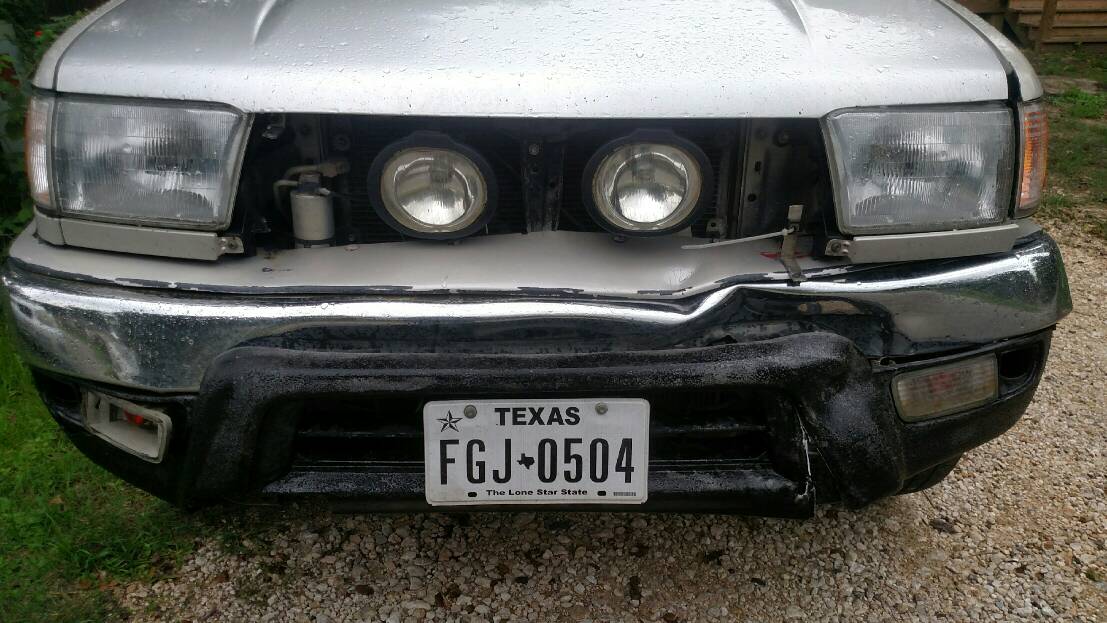

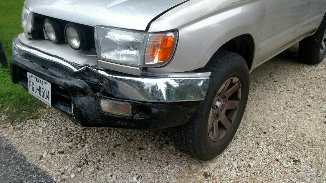

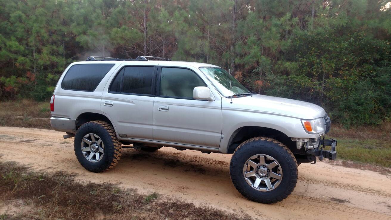

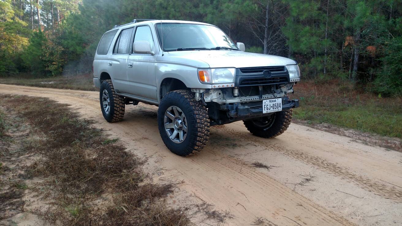

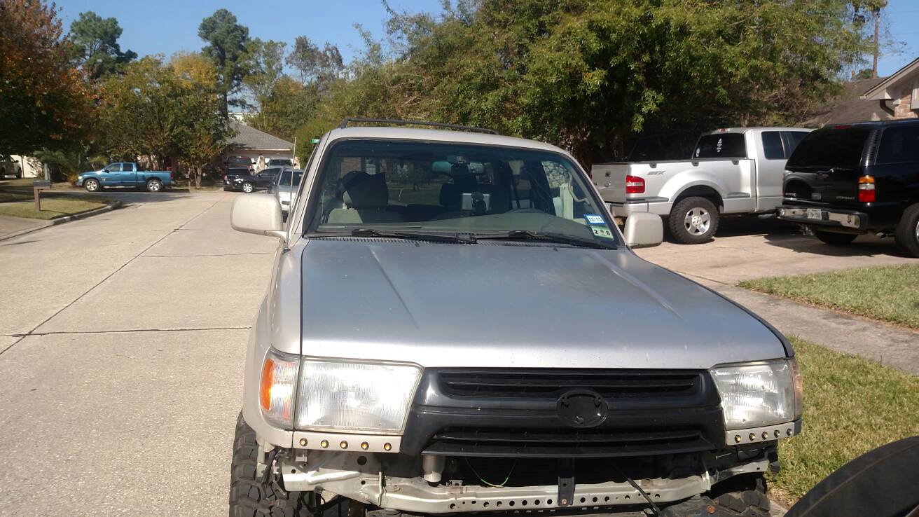

Luckily, no serious mechanical damage! Front clip was pushed in a little where the headlights mount, pulled it out and got it pretty straight. Replacement fender, replacement grill. Plastic welded the headlight buckets where the mount tabs broke off, and put new bulbs in while i was at it. Pulled the old bumper off, and decided since I now NEED a new bumper I might as well save a little and drop some cash on a tube bumper (coming soon). Since my turn signals needed to be replaced and I would be going with a different bumper I decided to make some custom LED signals to go in the headlight filler panel. My girlfriend was kind enough to make templates for me to follow for LED placement.

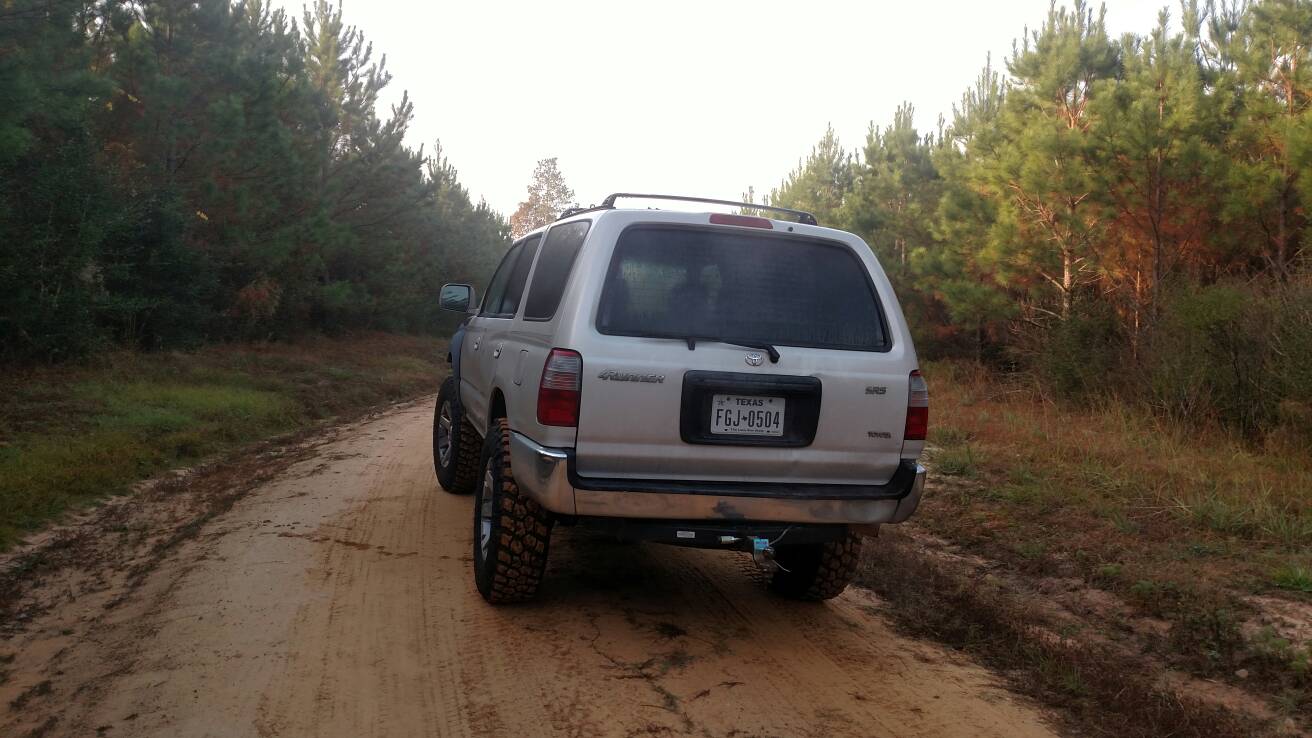

After that i decided it was time to replace the nearly bald 265/70/17 duelers that came on my trail edition wheels. Went with some 255/80/17 BFG KM2's. I went with a tall skinny tire to avoid rubbing the UCA and to not suffer power loss before regear. So far I'm really impressed with them. For the first 400 or so miles they felt like they rolled/bounced a little more than i liked, but now that they've broken in a little they feel very sure footed. They're quiet (we'll see how loud they get when they wear a little through) and ride good on the highway.

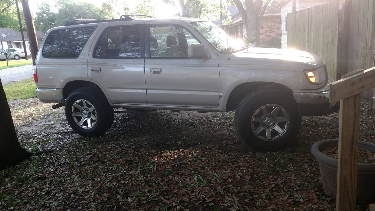

I rolled the pinch welds in the fender wells and did light hammer work on the floor pans (can't even tell with my weathertechs) to make sure i had a fair amount of clearance. I drove on them with no lift for a couple days (just commuting to work) they didn't rub, but obviously would have if i had gone off pavement. So, lift time! Saw a thread on here about using 2007 4wd fj cruiser coils and decided to give it a shot since i wanted to keep it mostly stock for now. It netted me about 1.5" all around and rides pretty good. Feels less like a soccer mom grocery getter and more like a truck. County roads to my deer lease used to beat the sh*t out of me, but not any more!

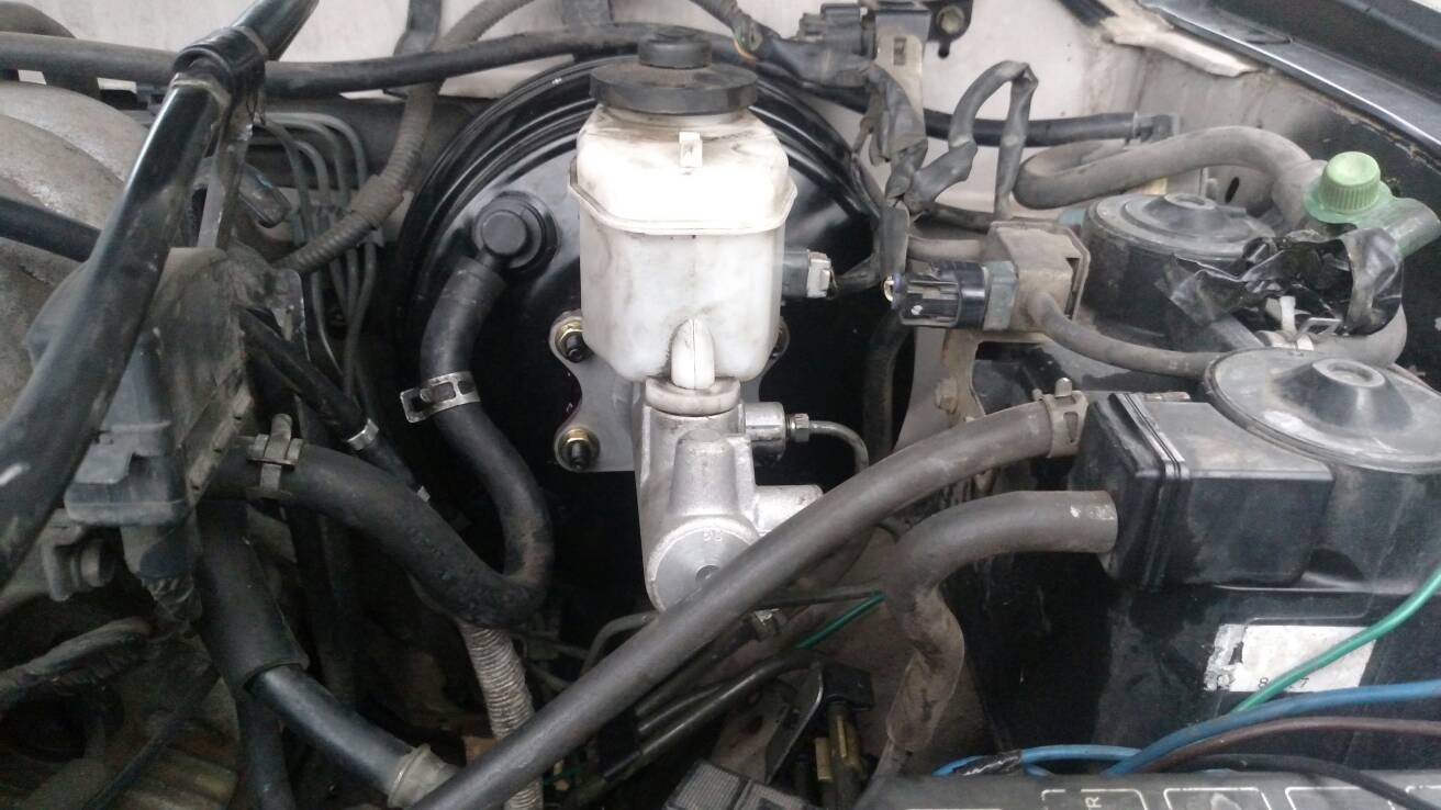

Update time. So, after doing the tundra 231 upgrade i never liked how soft my brake pedal was, Despite bleeding the system and verifying that everything was adjusted and working properly. I then started to get gremlins in my ABS system. On several occasions, on dry pavement, under light braking, my brakes would go into full lock accompanied buy harsh grinding sounds. no amount of pedal pumping would unlock them. Scarry stuff, went skidding though an intersection on one of those occasions. Luckily, no one else was in the intersection. Started checking my system out. Sensors and pump all in perfect order, no ABS light on, ever (yes i verified that the indicator was working correctly also). Several people have had this same problem and the cause seems difficult to pin down. So, being that this was my first vehicle to ever have ABS, I'm used to non ABS and had no problem yanking the fuse and not looking back. This however highlighted the fact that my stock master cylinder seemed to not be able to keep up with the larger front calipers. It seemed like when my brakes would lock, the master couldn't move enough fluid to unlock them. So, after some research, i found a few options for upgrades. I ultimately decided on a master/booster combo from a 97 t100. 1ton. My booster was in working order, but the 1 ton master is a 4 bolt, so i grabbed both to simplify things. The master has a 1 1/16" bore vs the stock 1". This doesn't seem like a huge increase, but i felt like i didn't need much considering my rears are still stock. For whatever reason no one sells the 1ton master with the reservoir locally. After eyeballing it though, i was pretty sure it was the same as the one in the 4runner. I swapped them in today without any issues. The reservoir fit perfectly, the booster pedal linkage rod is the same length and thread as stock, the brake lines are the same thread. Results; much firmer, better feeling brake pedal. I even locked it up on the way home (cat ran out in front of me and it was raining) and was able to unlock and stop the truck with a quick half pump. Very pleased overall with the upgrade, and would suggest it to any one else with the same issues.

Nice MC upgrade! I haven't done much reading on the 231 upgrade, but by the reports I've heard of soft- or long traveling- pedals, I knew I would be using a bigger MC when I install my 231's.
Were you able to grab OEM parts from a yard?
