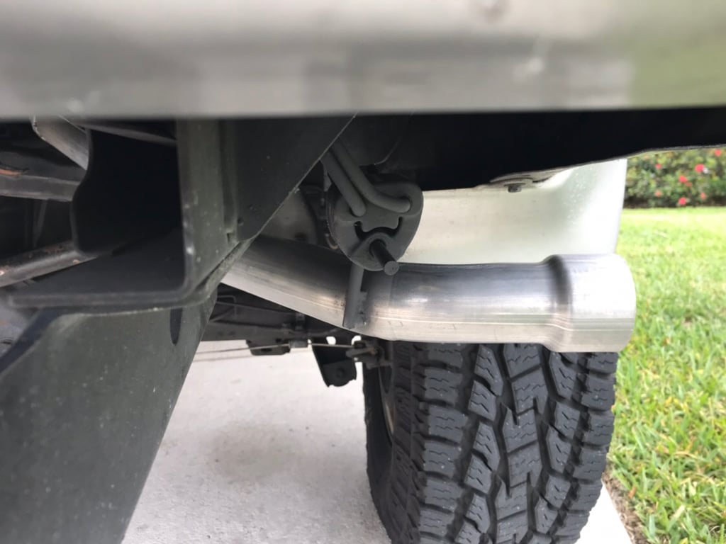

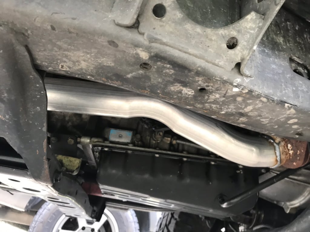

No one ? Ok I went a different route. Went to two muffler shops. Keep in mind I have after market exhaust installed 7 years ago. The previous install was too close to the crossmembers. 1st shop said I need a new muffler $450 (bwahahahahaha), 2nd shop a year later said components were could, they recommended starting over with the piping $250. Done. No more rattle.
