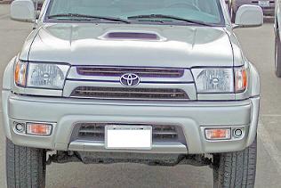

Carfax checked out great. Buddy mechanic checked out great. Maybe it just leans to be cool, like the James Dean Lean. Here are some pics if I get them on here right....oops, file too big, will modify and try later, will just show it leaning.....
lean can be seen slightly in this pic
I took your advice......better safe right????

you can really notice it looking at the control arms. mine isn't that noticeable and it's a 98. besides sagging springs; I'm kinda clueless as to what it could be.
