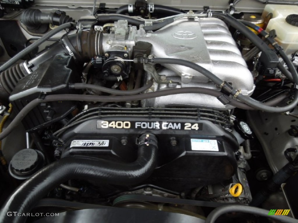

I noticed on my new 4Runner that a vacuum hose is off and kind of pushed down to the side. Does anyone know what this is for or if it should be off? Thank you!!

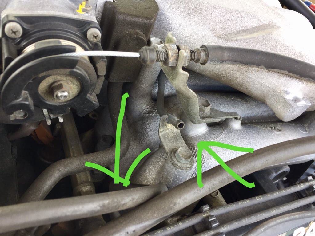

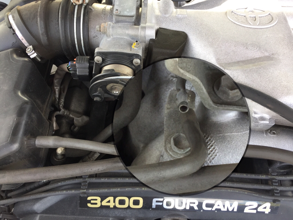

If I'm not mistaken this connects to the fuel pressure regulator located behind the plenum. Look at this picture and connect accordingly.
