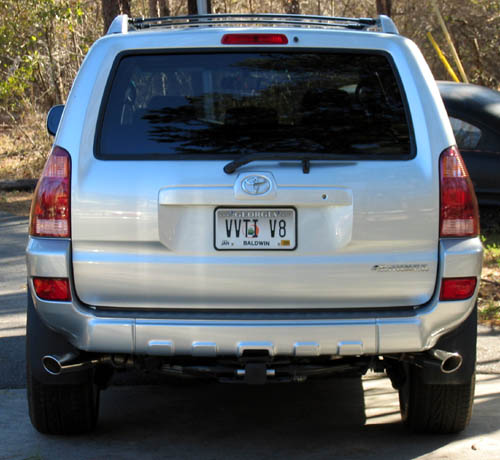

I ordered the TRD cat back exhaust for my 05 4Runner Sport V8....I was assured that the TRD cat back exhaust for the 03-04 was the same for 05...the exhaust does fit on BUT the spare tire will not fit anymore....is there a different exhaust for the 05 4Runner? is so, I need to get the dealer to correct this problem ;) thanks
other than the spare tire not fitting, it looks and sounds GREAT!
someone please verify that the 05 can not use the exhaust from the 03-04 so I dont think i'm crazy

the TRD did align just fine and everything bolted up perfectly...it just doesnt leave me enough space to keep the spare tire :(
i will call the dealer i got the exhaust from in the morning and see what he's gonna do to fix the problem ;) as I have everything saved where I kept specifying that I had the 2005 Sport 4.7L V8 4WD w/ xreas ;)

the exhaust bolts up just fine...but in their installation instructions, the picture shows the driver's side exhaust pipe running between the spare tire and the frame....on my 05 Sport, the spare tire is right up on the frame...no room for the pipe to go between... maybe this is extra space taken up by Xreas?? anywayz, right now i have the exhust on, but no spare tire.
