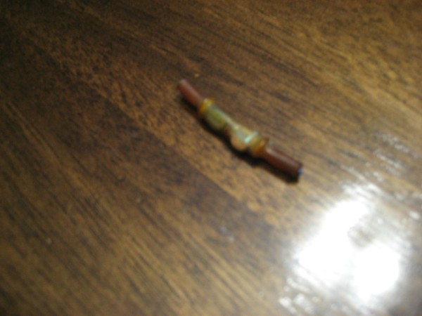

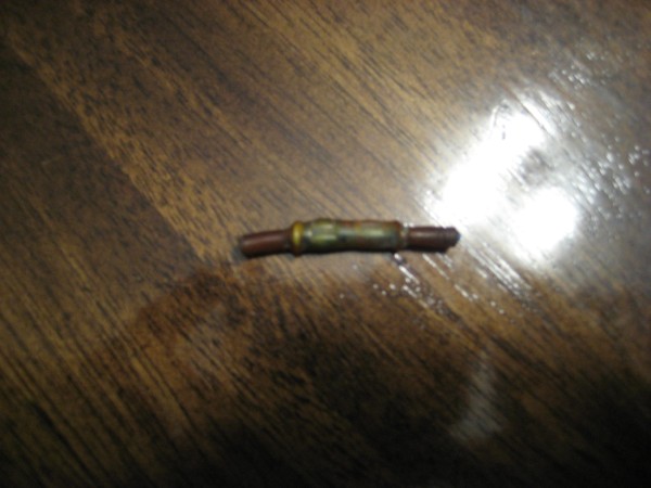

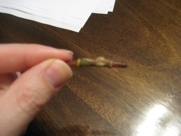

I had the 4r at the dealership to finally diagnose my hatch issues which were identical to the ones Toy-Man posted. It turned out to be the same diagnosis as Toy-Man, a bad wire in the hatch harness. The service counter rep was unable to clearly say where exactly in the harness it was. He said it looked like a previous repair/splice mid wire, but it seemed like a fairly good repair if it was. It was a crimped connection that was shrink wrapped with a tough rubber/plastic seal. I almost think it was from the factory. Maybe someone can see if they have the same splice somewhere. You can still see it was a blue wire, but I'm not sure where it was or what it powers. They kept the section they cut out which included the splice. These are the pics.
He also said there was a little corrosion on the ecu connectors, but not enough to cause this situation. It was definitely the bad wire. They cleaned up the connections, soldered the wire splice, and shrink wrapped it, then sent me out the door. I paid $400, and minus a $30 coupon, I walked out paying $370, all for labor and diagnosis…no parts. A lot of money for another bs repair, but I’m glad it’s fixed. Especially because I was thinking it was the Rear Door ECU or the motor latch assembly, both pricier fixes.
Again, my symptoms were identical to Toy-Man, I mean identical.
