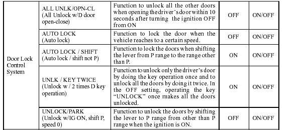

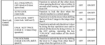

I have attached a list of items that can be customized. Unfortunately, it says a "hand-held tester" is required to make the modifications.
I have the programming instructions for the tester, but it was too large to post here.
I guess I will take these two documents to my nearest dealer and have them make the changes for me.

settings changed by directions in manual:
What i found was each setting is toggled
if one is on you must turn it off and then
toggle the setting you want .
in other words if your doors lock when
the truck obtains a certain speed then
you must toggle that off before you set a
different setting. sounds weird but it worked
for me.

What i found was each setting is toggled if one is on you must turn it off and then toggle the setting you want . in other words if your doors lock when the truck obtains a certain speed then you must toggle that off before you set a different setting. sounds weird but it worked for me.
Which settings are you talking about?...are you referring to the configurations that I posted in the PDF?
Dave
yes but only these

Thx guys had mine programmed by the dealer today.
So now all the doors unlock with first press of the remote. Doors no longer lock after taking it out of Park, but rather when the 4Runner reaches 15MPH. Also all doors unlock when I put it back park and the ignition is still on.

These are called Customizable Body Electronics System, or C-BEST settings.
(Adding this note so a search for C-BEST or CBEST hits this thread.)
